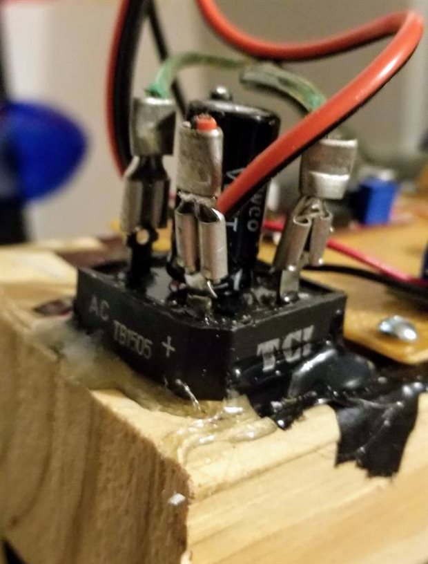

Bridge Rectifier - I put a bridge rectifier on the output of the dynamo  (I just like using that term for some reason) because I didn't know if a kid would be turning the crank clockwise or counter clockwise.  By using the bridge rectifier, I could be confident that the input to my actual circuit would always be positive.  There is some loss due to the way the bridge rectifiers work, but it will be minimal for this application.  On the output of the rectifier I slapped a beefy cap to help smooth out the fluctuations being generated by the user.  I've had this rectifier lying around since my first Christmas project (my original Christmas Countdown that is on my webpage) back in 2004.

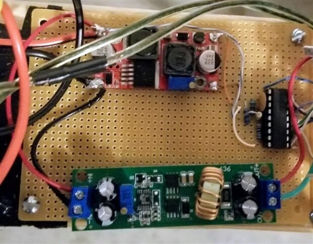

Voltage Regulators - There are two different regulators in the system that are both putting out 15VDC.  At the end of the day, they are both taking the dirty DC voltage off of the rectifier and producing 15VDC for the system.  The reason there are two doing the same thing is that originally I had the LM3914 running off of 15V, and the lights running off of a different voltage.  Once I went aways from high powered LEDs to the incadecent bulbs I ended up with, I happened to be back at 15V on the second regulator as well.  Both of these devices were purchased off of Amazon.

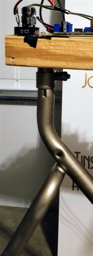

The project box with the crank and electronics sit on an old school exercise bike I got from someone's garbage.  This was the kind that had an actual bike chain and everything (VERY old school).  I stripped it down and pained it gold.  Then I drilled holes into the box's base and mounted into it the rod that the seat was attached to as well as the bottom part of the handles.  With that mounted to the 2x4, I can wiggle it back into place (a bit of a pain since one rod goes vertical and the other at an angle) and bolt it to the bike with the original hardware.  I can put it on and remove it at will, but I probably won't do it often.
The whole display worked like a charm once I added reinforcement to the back of the display box to the ground via pipes sunk 3ft down.  Kids absolutely loved it and it stood up to the wear and tear better than I thought it would. I was happy with this addition to the display this year.
