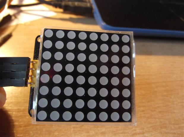

I have used the Keyestudio 8x8 Dot Matrix Modules before so decided to use them for this. I wanted to use more than one 8x8 dot matrix displays but I also wanted to 3D print a case for it. As my printer is not that large I compromised on only using two of the dot matrix displays. This is enough to show that it will all work yet still be within the capability of my printer. These displays have an I2C interface so can be connected in parallel, which made things much easier, but they are quite demanding of power so need a lot of current (when LEDs are on) so long term battery operation is probably not going to happen. I wanted to use a recorded holiday message so I used an ISD1820 PCB module I already had. It is not brilliant but is easy to use. The sound is recorded into the module once using the on-board record button and then played back using the P-L connection (or PLAYL button).

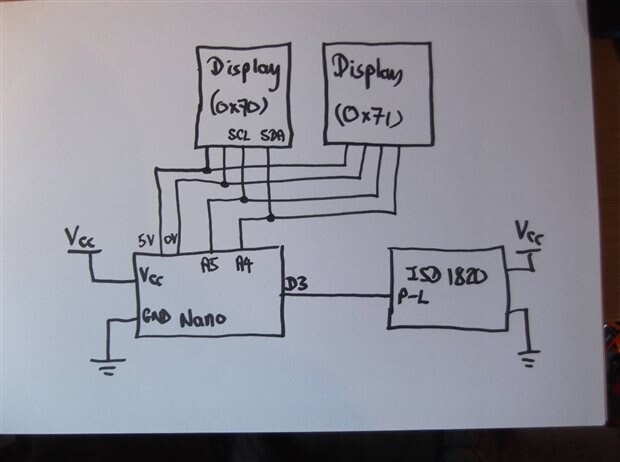

The complete circuit is very simple as shown below:

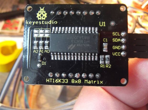

The dot matrix displays have a default I2C address of 0x70 but there are three user selectable (by soldering) address bits allowing a range of 0x70 to 0x77. One display was left as the default 0x70 and the other amended to 0x71 by adding a solder blob to the connections just above the A0 address signal.

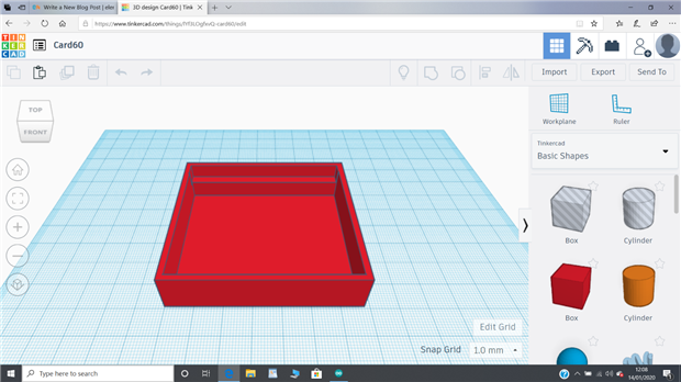

The 3D Print
I use TinkerCAD for my 3D prints and below is an image of the designed box. There is also a lid to fit at the back to make it look a bit prettier.
It is a simple design, just being a shallow box exactly the same width as two dot matric displays. I designed the displays to be an interference fit so that no screws would be needed although I still put in a ridge at the top that could be used to screw the displays to if needed. Unfortunately the printer was having an off-day and the top of the box was very badly printed. At this point I ran out of filament, as well as time, so there was no opportunity to reprint. I just had to sand it down and make the best of what I had.

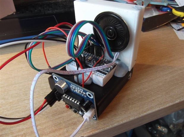

As I had run out of filament and time I was unable to design and print the battery holder and back of the whole box. Being resourceful (and desperate) I decided to just Blue-tac the display box to a battery holder (4xAA) and use some white card to make a more acceptable shell. It looks OK from the front, but from the back, not so good.
Sound
As I was using a self-contained sound module the only connections needed were power (GND and VCC) and P-L (D3 on the Nano). I just Blue-taced the speaker to the back of the display box and the sound PCB to the end of the battery holder. It doesn't look good, but it works and holds together.

There is a problem with the sound which only works correctly when the programming USB cable is plugged in. I am assuming that this is some sort of power supply problem with the displays causing some sort of power glitch when powered on. I was unable to rectify this problem so when powered only by battery the only sound heard is "Mer" ! The displays work fine though. I did try to get the display to update column by column rather than character by character to give a much smoother scrolling effect but it just would not work properly and my brain was beginning to hurt - so I gave up. Maybe some other time I'll have another go at column scrolling.
