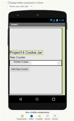

  • 6. Android app

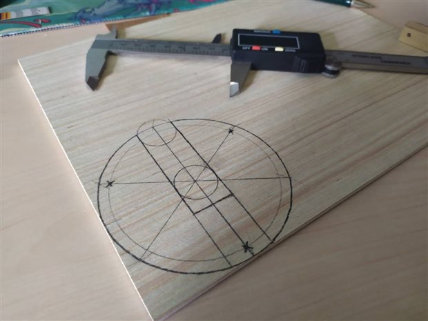

The baseplate will be made using regular plywood which can be bought in bookstores, the 4mm thick one that's used in schools, the pistons as well as piston guides are made of 12 by 12mm planks, the motor mount uses a off the shelf motor mount with a small plywood disk I made and in the piston connecting rods are made out of thin metal which I cut, bent over and drilled holes to attach it to the mechanism. With the general idea out of the way, it's time to start making this mechanism.
Build
     For this part of the build the main material will be wood, more specifically the 4mm thick plywood used in schools. I love using it, it's easy to obtain in any bookstore and it's really easy to work with. Besides that I'll be using 12mm by 12mm wooden planks, I got them from a local hardware store. I will be using them to make the pistons as well as the piston guides.

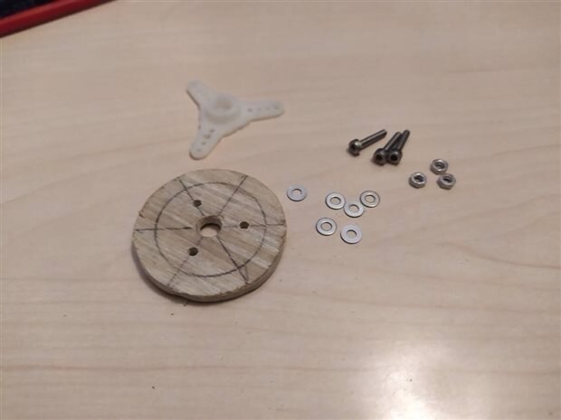

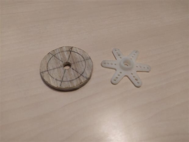

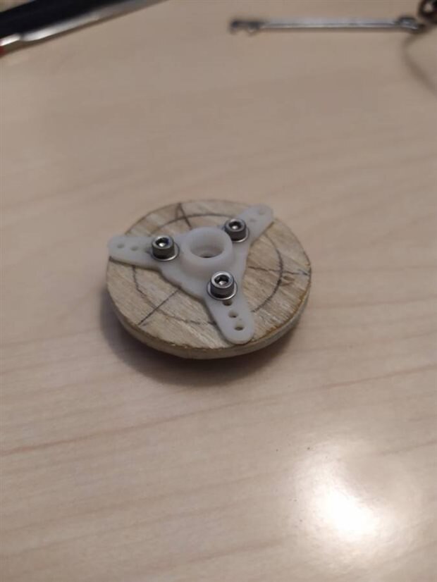

     I will be using  a motor mount that already came with the motor, but, it needs an additional attachment. The one I am using has 6 legs, but they are so thin, that I wouldn't like to attach bigger screws to them, so I cut a 35mm diameter circle out of plywood which I then attached to the motor mount.
{gallery} Motor Mount
IMAGE 1: Motor mount and wooden disk
IMAGE 2: The fit is excellent, but the mount needs modifying
IMAGE 3: I cut off 3 of the legs, so I can further in the build mount bigger screws easier
IMAGE 4: I drilled 3 small holes for attaching the 2 together
IMAGE 5: Finished mount, I only later drilled the screws holes which attached to the piston connecting rods
Fullscreen 2063.contentimage_128056.html Download
<html><head><title>Jive SBS</title></head>
<body><font face="arial,helvetica,sans-serif">
<b>Error</b><br><font size="-1">
An general error occurred while processing your request.
</font></font></body></html>
IMAGE 6: Here is how it looks mounted to a servo

Base

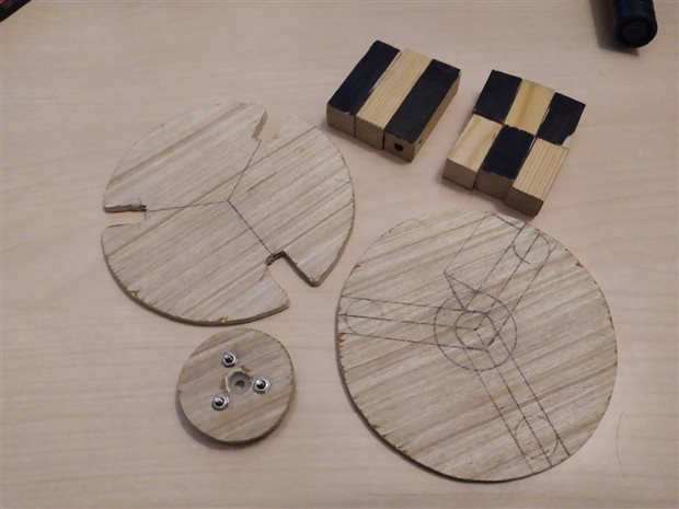

The lines that can be seen drawn on the right base plate are the guides for putting the pistons, as I've shown in my design I went with a 3 pistons design. The diameter of the base plate circles is 45mm, pistons are 40mm in length and the pistons guides are 25mm.
{gallery} Lower Layer
IMAGE 1: Attaching the first piston guide, I held down the piston in place with a small clamp, and put a piece of cardboard next to it, while I glued it in place

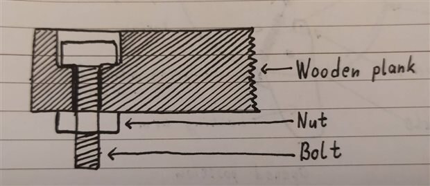

     The pistons are made out of the wooden planks and they are 12x12x40mm. All they need is a hole for the bolt to go through, to which the piston connecting rod will attach.
To make the holes I just used 2 different sized drill bits. First the thinner one that went all the way through, and then I took another one which was wide enough for the head of the bolt to fit, and drilled about half way into every piston. I ended up with this:
The grooves cut into the upper base plate are so the bolts can go in them. I decided on attaching the bolts at this end rather than the other one like on a car, because this way the mechanism will function more smoothly. The piston connecting rods are longer which means as the mechanism is let's say, pushing the pistons out, there will be some force on the piston guides as the piston connecting rod is not pushing straight on, but because it's longer than attaching it at the near end, that means that the force that we need, that actually pushes the piston out, is far greater than the force pushing the piston into the piston guides. Here is a picture of how the pistons fit into the mechanism as well as a demo of how the mechanism is working. I didn't have the connecting rods made yet, so I just used small pieces of cardboard instead.

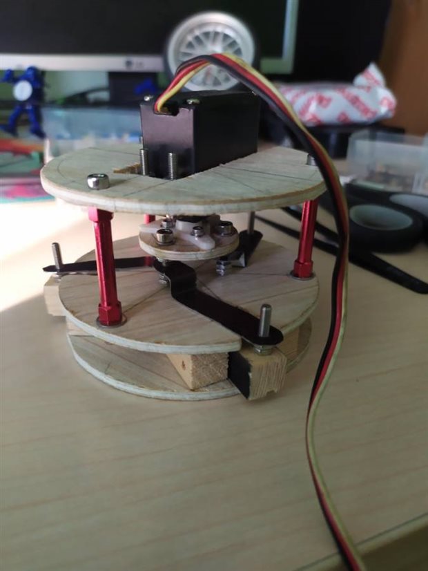

Servo holder and final pieces of the mechanism
     The only thing left to do now is to mount the servo and connect everything together, for connecting the servo to this I decided on going with another base plate above the second one which will hold the servo as well as all of the electronics. I used 40mm spacers scavenged from an old drone.
{gallery} Mechanism Final
IMAGE 1: Aluminium spacers for separating the 2 layers
IMAGE 2: Servo is 20mm in width, so I decided to cut out a slow ~20mm wide to the servo can slot in
IMAGE 3: Small wooden blocks I cut out for attaching directly to the servo with a couple of bolts, the only thing left is to glue in the servo like this using this small wooden blocks, and the mechanism is complete

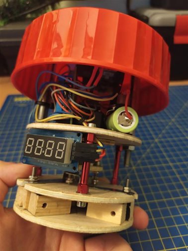

IMAGE 4: And here is how it all looks when it's put together, all that's left now is to try it out
Test
     I did a few tests to find out which are the correct angles for this set up for my servo, connected it to the Arduino and here is how it all looks. I'm really happy with how it's working and how it turned out in the end. I tested it with the jar and it all fits when the pistons are in, but it can't go through when the pistons are out, just as we wanted!

Final Assembly
     All that's left now is to assemble everything and test it out. To assemble it, I will be adding all of the electronics on top of the upper base plate and servo motor, as well as from underneath the jar lid and the connect the 2 halves together. To make connecting everything easy I used double sided sticky tape for a lot of the stuff. Next to the servo I mounted the cell with both fuses on top of it, as well as the switch, on the servo I mounted the boost convertor and on the other side the small latching circuit. Here is how that turned out.
Now to mount stuff to the lid. To the lid i will be mounting the push button as well as the Arduino. One problem I encountered is that the relay shield I planned on using was a bit too long to fit on the list, so I had to cut off a part of it to make it fit, besides these, I put in 2 big and long bolts which connect to the upper base plate of the mechanism later on. Because the bolts didn't have a thread all the way through, I had to put plastic tubing around the bolts which acted as spacers for mounting everything together.
With 2 more holes drilled into the top base plate and some wiring I ended up with the final hardware look for this project.

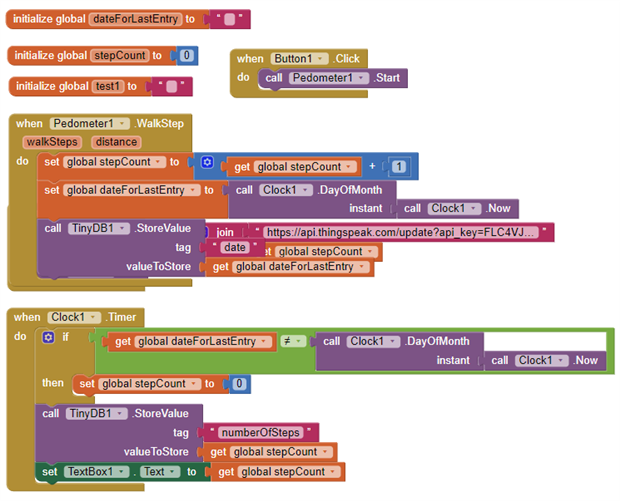

6. Android app
     My first idea was to try and get data directly off of an existing step counter app like Strava or Google Fitness. While doing some researach on this topic Google Fitness seemed like the most plausiable way of doing this, but as I tried experimenting with it's REST API I managed to extract the number of steps to show up on screen, but automating that for it to upload that data to Thingspeak seemed impossible in a reasonable amount of time for me. So instead I decided to make a small step coutner app using MIT App Inventor 2. I simply love MIT App Inventor since it's drag and drop programming for Android with which I had some experience writing codes from zero, and let's just say, that it's so much easier to do it with this service, specially when something is in a prototype phase like this, but I've also seen really polished apps coming out of it as well.
Here is how the app works, the service already has a built in pedometer component so we just have to call it everytime it detects a step to incremenet the number of steps. Using timer clock 2 we upload the data online every 16 seconds, because the maximum rate for uploading to Thingspeak is every 15 seconds, while with the timer clock1 we save all of the data on the phone. By comparing if the date is the same as the last date that was recorded for the step we can reset the number of steps to zero when a new day comes, and that would be all for the app.
