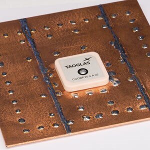

After consulting the module documentation, I settled on a Taoglas antenna (PDF datasheet), which is a 1-inch square device, that needs a 70x70mm ground plane preferably. There were various options; I went with an antenna that is mounted on the reverse side of the board. It is stuck down with double-sided adhesive tape, and then the pin is soldered.
I used a copper-clad board since I had not designed a PCB yet. Ideally it should be double-sided. Mine was single-sided, so I put copper slug tape on the other side, and then patched both sides together with loads of holes and wire links soldered through them all. This part of the exercise was time-consuming and was not fun!
The Lantronix Teseo III module was tricky to patch wires onto. A PCB as mentioned would be far easier.
When powered up, the prototype immediately functioned, which was a surprise, because the board was not close to a window; it was several meters away. I had not expected that, given the construction method. The Teseo III module and the Taoglas antenna seem to function well together, but it would be interesting to try other antennas, and/or a low noise amplifier (LNA) one day.
Anyway, long story short, since the prototype worked, I went ahead and produced a KiCad PCB design, which broadly follows the prototype layout. The boards should arrive in a couple of weeks.
