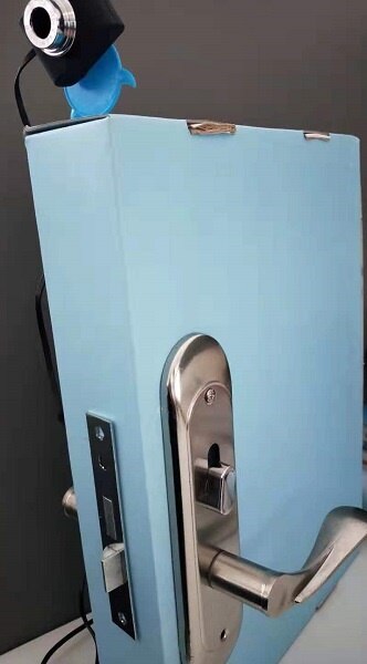

Forget your KEY and your SECRET PASSCODE? That is OK if you are with AILOCK.
You can have one with BeagleBone AI and do it by yourself in FOUR
1st Hour, unboxing and start coding immediately, crack the code with bare C++ in one of PRU ARM-M4 core,
BBAI with Out-of-Box ecosystem makes everyone build AI application with ease. If you want to dig further  with extended capabilities , Refer to my Animation Project Scary Door  and BeagleBone AI - Review .

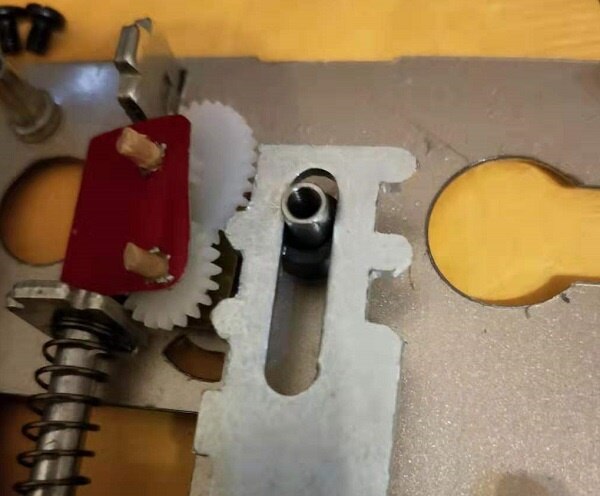

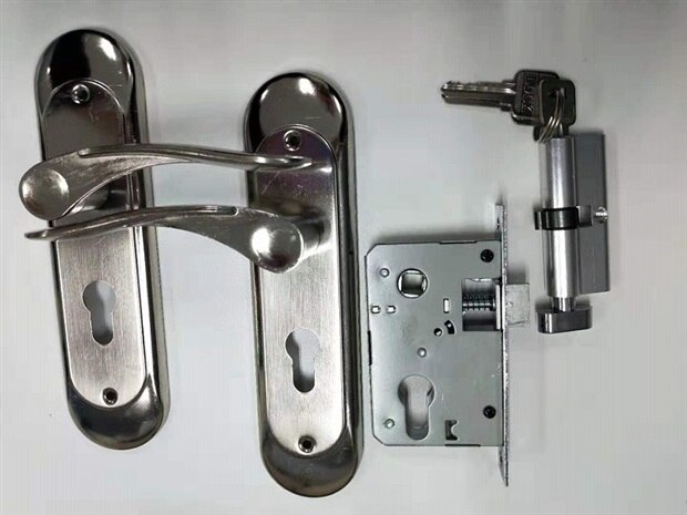

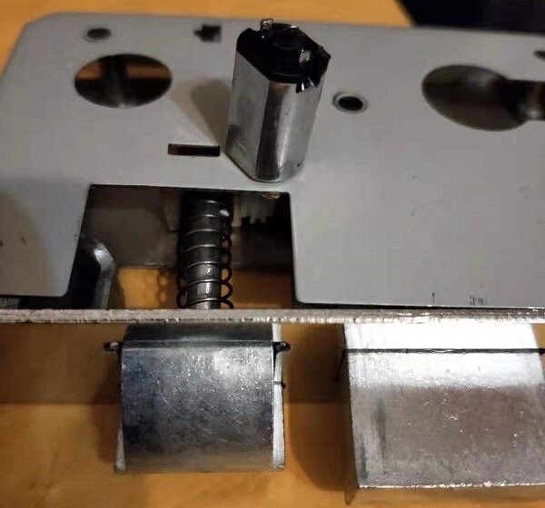

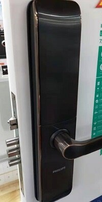

Simple as it it, you can not return your home if you misplace your key.

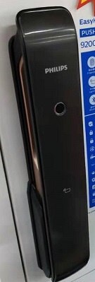

You can have smart door lock below,
But still not smart enough, the lock only knows the NFC tags and Mobile Open Tokens, or the smartest one which knows your fingerprint.

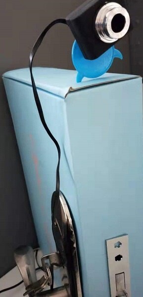

You can choose to have one lock knows you and only you with deep learning Computer Vision (CV).

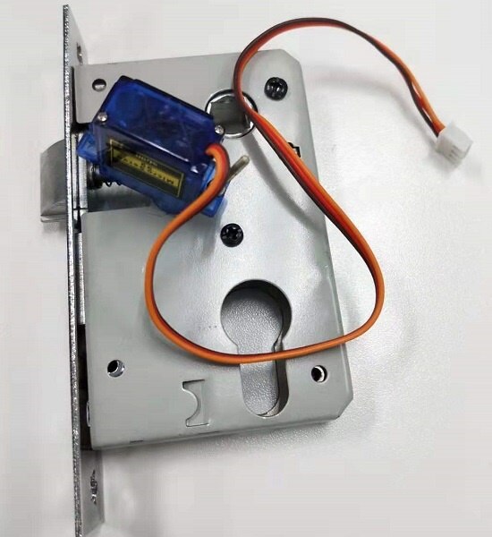

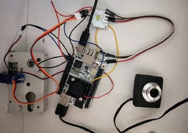

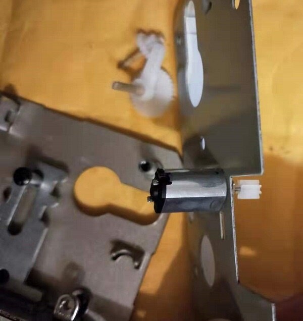

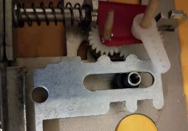

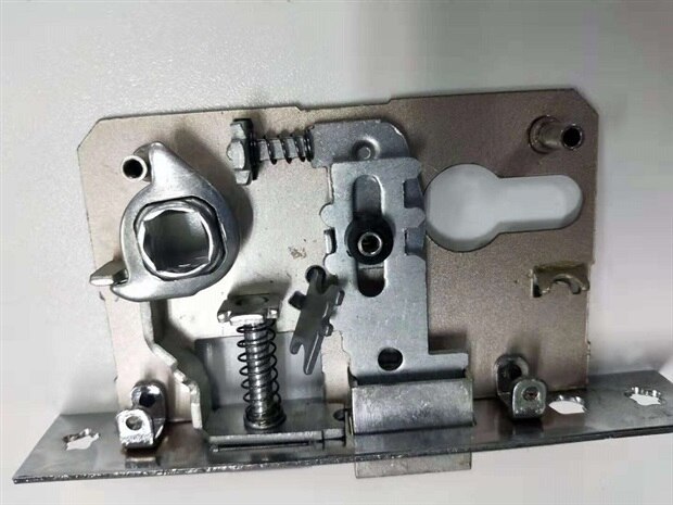

1.2 What to Have
- One BeagleBone AI board, with embedded software for everything
- One USB Camera
- One 3.3V DC motor
- One normal door lock for refurbishment
- No more development software needed, you have C9 Cloud already

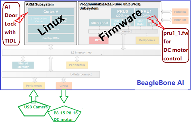

As far as I know, BeagleBone AI is the first Industrialized products for AI application. Complete development ecosystem and fastest deployment.
For this aiLock, the Block Structure shall be
2.1 Versatile Inter Processor Connection, Remote Connection and PinMux

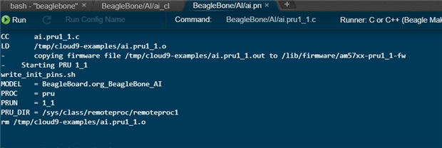

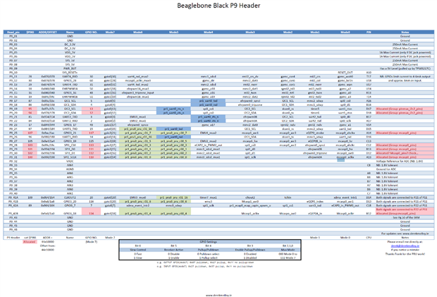

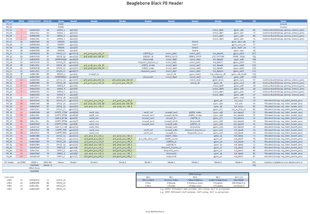

PRU-- Programmable Real-Time Unit Subsystem and Industrial Communication SubSystem (PRU-ICSS) consists of dual 32-bit RISC cores (Programmable Real-Time Units, or PRUs), data and instruction memories, internal peripheral modules, and an interrupt controller (INTC) with dual ARM Cortex-M4 subsystem. This is best choice for GPIO control and can even be programmed into I2C, SPI, CAN communication protocols as you like. Best thing is that if you use register _R30 , no need to turn off triggers or set pin direction.
Here is code for PRU, with direct access to PinMux, sharememory shall be used as IPC between PRU and Linux Core.
// ailock.pru1_1.c

Build and RUN,

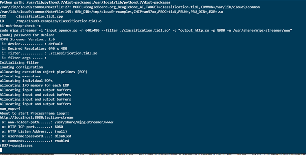

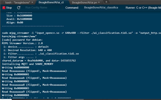

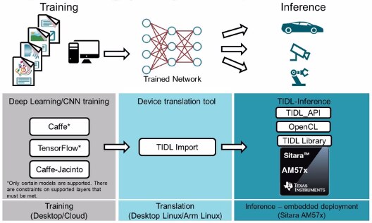

2nd Hour, Go to deep learning part with TIDL, read through Classification Demo Code and revise it,
LINUX APPLICATION --The LINUX core runs on Dual ARM Cortex-A15 subsystem supporting the most desirable Deep Learning Framework. Easy to deployed two TI C66x VLIW floating-point DSP core and Vision AccelerationPac (with 4x EVEs) are core engines in accelerating the intense computing load.
Here is full code on LINUX APPLICATION,, based on classification demo code,

printf("shared_dataram = %p, and data=%d \n", shared_dataram,*shared_dataram);

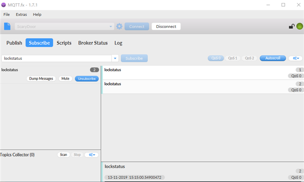

mosquitto_lib_init();
    mosq = mosquitto_new(NULL,session,NULL);
    std::cout << "Initializing MQTT and SHARE_MEMORY" << std::endl;
    if(!mosq){
        printf("create client failed..\n");
        mosquitto_lib_cleanup();
        return 1;
    mosquitto_username_pw_set(mosq,"scaryball","scaryball");
    if(mosquitto_connect(mosq, HOST, PORT, KEEP_ALIVE)){
        fprintf(stderr, "Unable to connect.\n");
        return 1;
    mosquitto_publish(mosq,NULL,"lockstatus",strlen(buff)+1,buff,0,0);
    memset(buff,0,sizeof(buff));
    flip_test();
    std::cout << "Initializing filter" << std::endl;
    populate_labels("/usr/share/ti/examples/tidl/classification/imagenet.txt");

        std::cout << "About to start ProcessFrame loop!!" << std::endl;
        std::cout << "http://localhost:8080/?action=stream" << std::endl;
    catch (tidl::Exception &e)
        std::cerr << e.what() << std::endl;

Here is some screenshot result,
Program starting,
One glass was detected , that is my eyeglass,
UI -- Computer Vision shall be displayed vividly for humans. User friendly Interface shall be provided. LCD panel, LED indicator, mobile APP, HTML page can all be proper choice.
Therefore, Intercommunication for PRU, LINUX APPLICATION and UI shall be configured reliable and elastically. In BeagleBone AI , IPC(Inter-Processor Communication) in shared memory is idea for  PRU vs LINUX APPLICATION. Message broker service like MQTT is idea for LINUX APPLICATION vs UI.
The code for MQTT implementation on HTML web page or other portal is easy and reliable. MQTT server can run on local BeagleBone AI or remote Broker Server like arduino cloud.
Mosquitto Broker listen on port 1883,
Refer to the screenshot from MQTT.fx for information,  MQTT topic "lockstatus" was published twice from LINUX APPLICATION above,
Other code would be added later.

2.2 Deep Learning with TIDL
In the center of LINUX APPLICATION aboveis TIDL. TIDL(TI Deep Learning) enables Deep Learning compute workloads from Arm cores to hardware accelerators such as TI’s proprietary EVE and/or C66x DSP, with boosting performance. Google offer versatile Tensorflow Lite for embedded devices even on SAMD-core arduino board, with compensable performance optimization and deduction. This is why TIDL is so different in focus on performance boosting, refer to TIDL development flow diagram below.
  • Classification Model sample
This part is the same as previous code in LINUX APPLICATION part,
  • Select model and train with new data
The most challenge part, in most case, you can skip this part, since most of the work shall be done on GPUs, at least on your desktop. There have been many well trained model with years of development and research, if not for commercial, you can use them for free, sucha as  CAFFEE model ZOO.
4th Hour, fix one small 3V DC motor and try to make AI Door Lock work,
3 Hardware and Build
3.1 Normal Door Lock Breakout
Find one door lock and disassemble it.
3.2 aiLock Refurbishment
Replace on bottom plate and fix one small DC motor and trigger plate. Then wiring the DC motor to BBAI directly on PinMux in PRU part. In this case, P8_26 for LED and P8_15&P8_16 for door lock open motor.
Do not worried about the DC load, by mistake, I have blacked out the BBAI with one large DC motor. The TPSxxxx PMIC proves its value and protect the BBAI. Check the datasheet, DC motor load less than 1W means nothing to BBAI. Theheatsink above the AM57xx chip can boil one small quail egg if you really want a try.
After test,  very small motor can work on GPIO with maximum ouput of 5mA, but the torque is not enough to drive the handle, the gear set is small enough to fit into the lock case, and the motor can not fit in.
I shall design better hardware arrangement to put them all in most compact space later.
I have to select9g servo , with bigger size to show how it works.
3.3 aiLock fixed into Door
Wiring the BB AI and USB camera ,
Fix the lock back to the door, in reverse order you have disasambled it.

  • fyaocn
    fyaocn over 7 years ago in reply to phoenixcomm +2
    The door lock by Phillipe with picture in first chapter is robust enough. It can be fixed into steel frame with flexible control UI. This demo project only tries to demonstrated how BBAI is capable with…
  • fyaocn
    fyaocn over 6 years ago in reply to vimarsh_ +2
    This is one simple project. Only because the BBAI is of Great Design. The smart Phillips door lock is not SMART indeed, but cost $500 each, just combination of BLE mobile control, NFC reader and finger…

  • phoenixcomm
    phoenixcomm over 7 years ago in reply to fyaocn
    fyaocn your point is well taken. But to be sure, I prefer a deadbolt with no access through the lock itself. Only in the strike which is inside a steel channel.
    Your weak point is the motor in the door itself. which could be gotten to with a little work.
