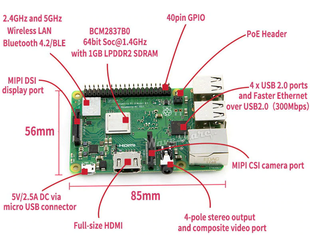

Raspberry Pi 3B+
[Image Source: Aliexpress]
  • Broadcom BCM2837B0 64-bit ARM Cortex-A53 Quad Core Processor SoC running @ 1.4GHz
  • 1GB RAM LPDDR2 SDRAM
  • 4x USB2.0 Ports with up to 1.2A output
  • Extended 40-pin GPIO Header
  • Video/Audio Out via 4-pole 3.5mm connector, HDMI, CSI camera, or Raw LCD (DSI)
  • Storage: MicroSD
  • Gigabit Ethernet over USB 2.0 (maximum throughput 300Mbps)
  • 2.4GHz and 5GHz IEEE 802.11.b/g/n/ac wireless LAN, Bluetooth 4.2, BLE
  • H.264, MPEG-4 decode (1080p30); H.264 encode (1080p30); OpenGL ES 1.1, 2.0 graphics
  • Low-Level Peripherals:
    • 27x GPIO
    • UART
    • I2C bus
    • SPI bus with two chip selects
    • +3.3V
    • +5V
    • Ground
  • Power Requirements: 5V @ 2.5A via a micro USB power source
  • Supports Raspbian, Windows 10 IoT Core, OpenELEC, OSMC, Pidora, Arch Linux, RISC OS, and More!
  • 85mm x 56mm x 17mm

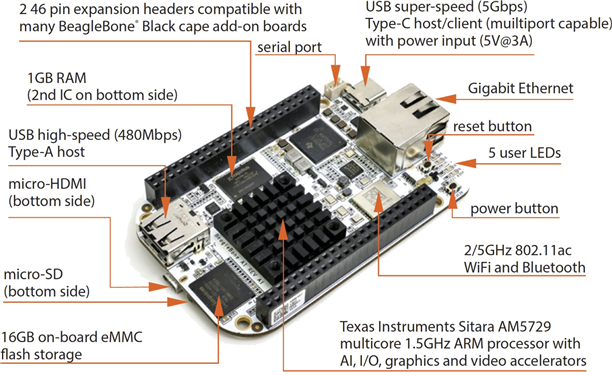

Beaglebone AI
[Image Source: Element14]
  • Processor: Texas Instruments Sitara AM5729
  • Dual ArmRegistered CortexRegistered-A15 microprocessor subsystem
  • 2 C66x floating-point VLIW DSPs
  • 2.5MB of on-chip L3 RAM
  • 2x dual ArmRegistered CortexRegistered-M4 co-processors
  • 4x Embedded Vision Engines (EVEs)
  • 2x dual-core Programmable Real-Time Unit and Industrial Communication SubSystem (PRU-ICSS)
  • 2D-graphics accelerator (BB2D) subsystem
  • Dual-core PowerVRRegistered SGX544Tm 3D GPU
  • IVA-HD subsystem
  • BeagleBone Black mechanical and header compatibility
  • 1GB RAM and 16GB on-board eMMC flash with high-speed interface
  • USB Type-C for power and superspeed dual-role controller; and USB type-A host
  • Gigabit Ethernet, 2.4/5GHz WiFi, and Bluetooth
  • micro HDMI
  • Zero-download out-of-box software experience with Debian GNU/Linux

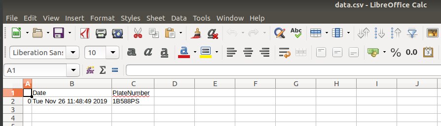

After the license plate is recognized, the data is written to a CSV file using Panda dataset.

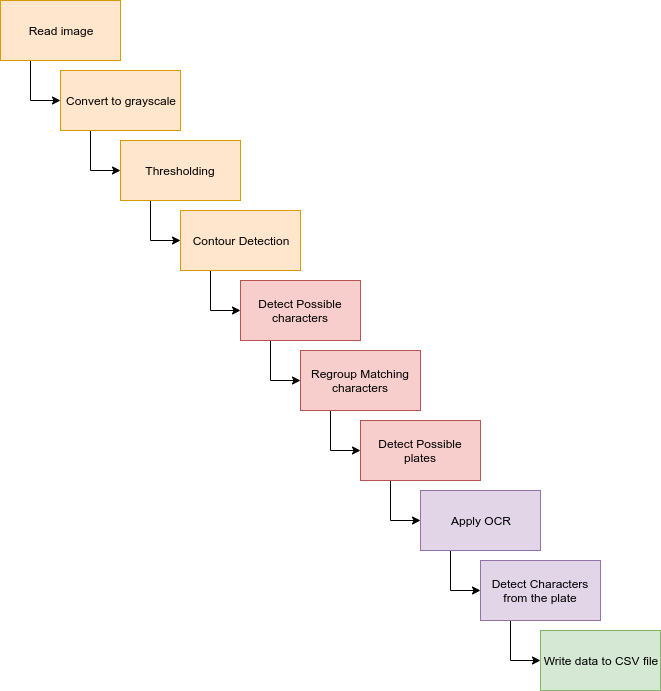

The procedure for ALPR will be briefly explained as follows:

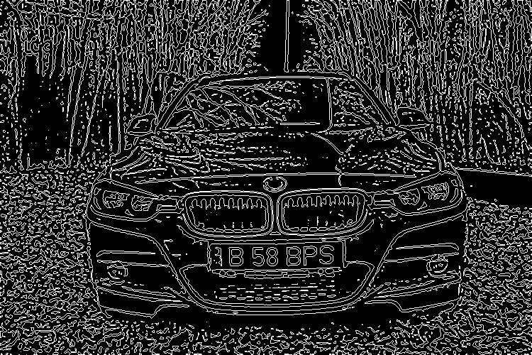

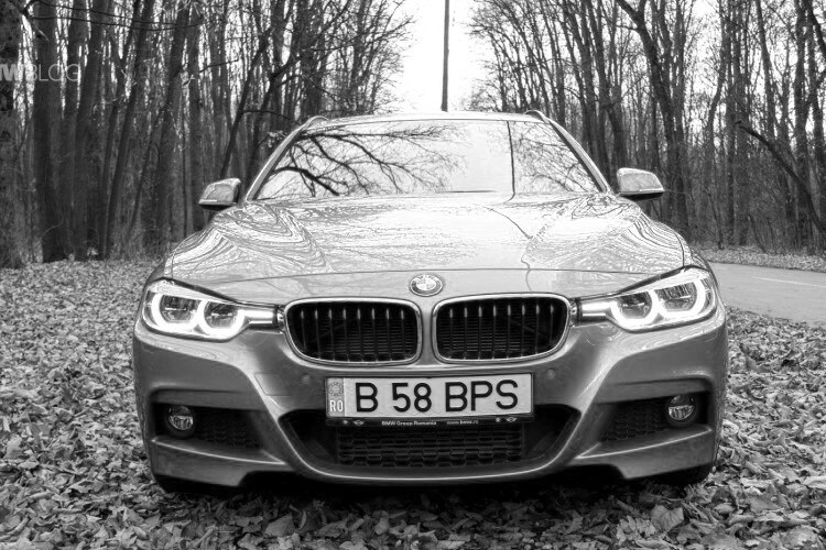

1. The Image is read by the program.  For testing, let's use a random vehicle image where the license plate is visible in the frame.
[Image Source: BMW Blog, https://www.bmwblog.com/2015/12/19/why-do-americans-put-european-license-plates-on-their-cars/ ]
imgOriginal  = cv2.imread("test.png")
2. Conversion to grayscale
height, width, numChannels = imgOriginal.shape
imgHSV = np.zeros((height, width, 3), np.uint8)
imgHSV = cv2.cvtColor(imgOriginal, cv2.COLOR_BGR2HSV)
imgHue, imgSaturation, imgGrayscale = cv2.split(imgHSV)
3. Threshold the grayscale image
height, width = imgGrayscale.shape
imgBlurred = np.zeros((height, width, 1), np.uint8)
imgBlurred = cv2.GaussianBlur(imgMaxContrastGrayscale, GAUSSIAN_SMOOTH_FILTER_SIZE, 0)
imgThresh = cv2.adaptiveThreshold(imgBlurred, 255.0, cv2.ADAPTIVE_THRESH_GAUSSIAN_C, cv2.THRESH_BINARY_INV, ADAPTIVE_THRESH_BLOCK_SIZE, ADAPTIVE_THRESH_WEIGHT)

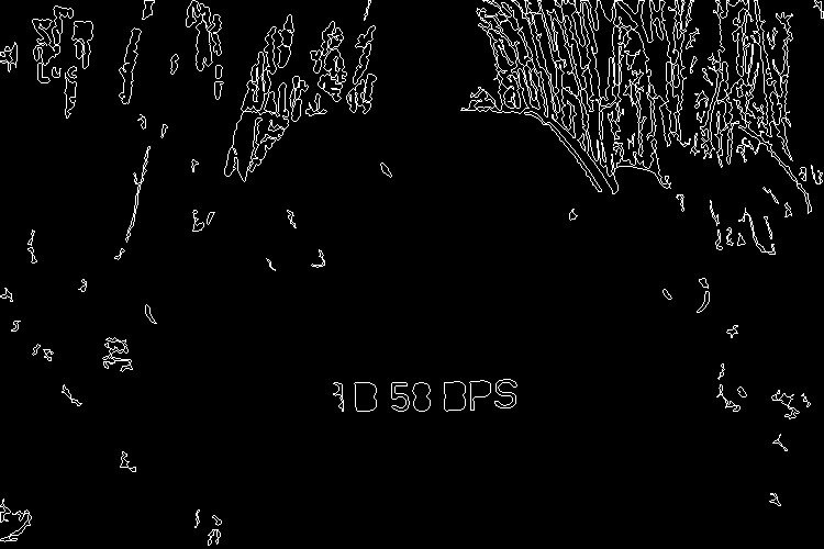

4. Contour detection
imgThreshCopy = imgThresh.copy()
imgContours, contours, npaHierarchy = cv2.findContours(imgThreshCopy, cv2.RETR_LIST, cv2.CHAIN_APPROX_SIMPLE)   # find all contours
height, width = imgThresh.shape
imgContours = np.zeros((height, width, 3), np.uint8)

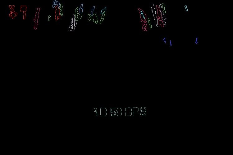

5. Detecting contours with possible characters
class PossibleChar:
    def __init__(self, _contour):
        self.contour = _contour
        self.boundingRect = cv2.boundingRect(self.contour)
        [intX, intY, intWidth, intHeight] = self.boundingRect
        self.intBoundingRectX = intX
        self.intBoundingRectY = intY
        self.intBoundingRectWidth = intWidth
        self.intBoundingRectHeight = intHeight
        self.intBoundingRectArea = self.intBoundingRectWidth * self.intBoundingRectHeight
        self.intCenterX = (self.intBoundingRectX + self.intBoundingRectX + self.intBoundingRectWidth) / 2
        self.intCenterY = (self.intBoundingRectY + self.intBoundingRectY + self.intBoundingRectHeight) / 2
        self.fltDiagonalSize = math.sqrt((self.intBoundingRectWidth ** 2) + (self.intBoundingRectHeight ** 2))
        self.fltAspectRatio = float(self.intBoundingRectWidth) / float(self.intBoundingRectHeight)
listOfPossibleChars = []
for i in range(0, len(contours)):
        cv2.drawContours(imgContours, contours, i, Main.SCALAR_WHITE)
        possibleChar = PossibleChar.PossibleChar(contours[i])
        if (possibleChar.intBoundingRectArea > MIN_PIXEL_AREA and
        possibleChar.intBoundingRectWidth > MIN_PIXEL_WIDTH and possibleChar.intBoundingRectHeight > MIN_PIXEL_HEIGHT and
        MIN_ASPECT_RATIO < possibleChar.fltAspectRatio and possibleChar.fltAspectRatio < MAX_ASPECT_RATIO):
            intCountOfPossibleChars = intCountOfPossibleChars + 1           # increment count of possible chars
            listOfPossibleChars.append(possibleChar)
contours = []
for possibleChar in listOfPossibleCharsInScene:
     contours.append(possibleChar.contour)
cv2.drawContours(imgContours, contours, -1, Main.SCALAR_WHITE)

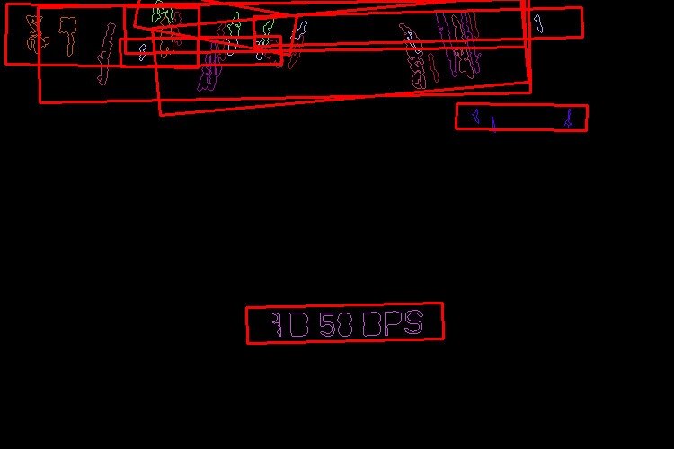

7. Detection of a potential license plates
    for listOfMatchingChars in listOfListsOfMatchingCharsInScene:
        intRandomBlue = random.randint(0, 255)
        intRandomGreen = random.randint(0, 255)
        intRandomRed = random.randint(0, 255)
        contours = []
        for matchingChar in listOfMatchingChars:
            contours.append(matchingChar.contour)
        cv2.drawContours(imgContours, contours, -1, (intRandomBlue, intRandomGreen, intRandomRed))
listOfPossiblePlates = []
    possiblePlate = extractPlate(imgOriginalScene, listOfMatchingChars)
    if possiblePlate.imgPlate is not None:
        listOfPossiblePlates.append(possiblePlate)
for i in range(0, len(listOfPossiblePlates)):
    p2fRectPoints = cv2.boxPoints(listOfPossiblePlates[i].rrLocationOfPlateInScene)
    cv2.line(imgContours, tuple(p2fRectPoints[0]), tuple(p2fRectPoints[1]), Main.SCALAR_RED, 2)
    cv2.line(imgContours, tuple(p2fRectPoints[1]), tuple(p2fRectPoints[2]), Main.SCALAR_RED, 2)
    cv2.line(imgContours, tuple(p2fRectPoints[2]), tuple(p2fRectPoints[3]), Main.SCALAR_RED, 2)
    cv2.line(imgContours, tuple(p2fRectPoints[3]), tuple(p2fRectPoints[0]), Main.SCALAR_RED, 2)
    print("possible plate " + str(i)")
    cv2.imshow("Plates", listOfPossiblePlates[i].imgPlate)

def findPossibleCharsInPlate(imgGrayscale, imgThresh):
    contours = []
    for contour in contours:
        possibleChar = PossibleChar.PossibleChar(contour)
        if checkIfPossibleChar(possibleChar):
    return listOfPossibleChars
def checkIfPossibleChar(possibleChar):
        return True
    else:
        return False
def findListOfListsOfMatchingChars(listOfPossibleChars):
    listOfListsOfMatchingChars = []
    for possibleChar in listOfPossibleChars:
        listOfMatchingChars = findListOfMatchingChars(possibleChar, listOfPossibleChars)
        listOfMatchingChars.append(possibleChar)
        if len(listOfMatchingChars) < MIN_NUMBER_OF_MATCHING_CHARS:
            continue
        listOfListsOfMatchingChars.append(listOfMatchingChars)
        listOfPossibleCharsWithCurrentMatchesRemoved = []
        listOfPossibleCharsWithCurrentMatchesRemoved = list(set(listOfPossibleChars) - set(listOfMatchingChars))
        recursiveListOfListsOfMatchingChars = findListOfListsOfMatchingChars(listOfPossibleCharsWithCurrentMatchesRemoved)
        for recursiveListOfMatchingChars in recursiveListOfListsOfMatchingChars:
            listOfListsOfMatchingChars.append(recursiveListOfMatchingChars)
        break
    return listOfListsOfMatchingChars
def findListOfMatchingChars(possibleChar, listOfChars):
    listOfMatchingChars = []
    for possibleMatchingChar in listOfChars:
        if possibleMatchingChar == possibleChar:
            continue
        fltDistanceBetweenChars = distanceBetweenChars(possibleChar, possibleMatchingChar)
        fltAngleBetweenChars = angleBetweenChars(possibleChar, possibleMatchingChar)
        fltChangeInArea = float(abs(possibleMatchingChar.intBoundingRectArea - possibleChar.intBoundingRectArea)) / float(possibleChar.intBoundingRectArea)
        fltChangeInWidth = float(abs(possibleMatchingChar.intBoundingRectWidth - possibleChar.intBoundingRectWidth)) / float(possibleChar.intBoundingRectWidth)
        fltChangeInHeight = float(abs(possibleMatchingChar.intBoundingRectHeight - possibleChar.intBoundingRectHeight)) / float(possibleChar.intBoundingRectHeight)
        if (fltDistanceBetweenChars < (possibleChar.fltDiagonalSize * MAX_DIAG_SIZE_MULTIPLE_AWAY) and
            fltAngleBetweenChars < MAX_ANGLE_BETWEEN_CHARS and
            fltChangeInArea < MAX_CHANGE_IN_AREA and
            fltChangeInWidth < MAX_CHANGE_IN_WIDTH and
            fltChangeInHeight < MAX_CHANGE_IN_HEIGHT):
            listOfMatchingChars.append(possibleMatchingChar)
    return listOfMatchingChars
def removeInnerOverlappingChars(listOfMatchingChars):
    listOfMatchingCharsWithInnerCharRemoved = list(listOfMatchingChars)
    for currentChar in listOfMatchingChars:
        for otherChar in listOfMatchingChars:
            if currentChar != otherChar:
                if distanceBetweenChars(currentChar, otherChar) < (currentChar.fltDiagonalSize * MIN_DIAG_SIZE_MULTIPLE_AWAY):
                    if currentChar.intBoundingRectArea < otherChar.intBoundingRectArea:
                        if currentChar in listOfMatchingCharsWithInnerCharRemoved:
                            listOfMatchingCharsWithInnerCharRemoved.remove(currentChar)
                    else:
                        if otherChar in listOfMatchingCharsWithInnerCharRemoved:
                            listOfMatchingCharsWithInnerCharRemoved.remove(otherChar)
9. Overlay the license plate number to the original image
listOfPossiblePlates.sort(key = lambda possiblePlate: len(possiblePlate.strChars), reverse = True)
    licPlate = listOfPossiblePlates[0]
    cv2.imshow("imgPlate", licPlate.imgPlate)
    cv2.imshow("imgThresh", licPlate.imgThresh)
    if len(licPlate.strChars) == 0:
        print("\nno characters were detected\n\n")
        return
    drawRedRectangleAroundPlate(imgOriginalScene, licPlate)
    print("\nlicense plate read from image = " + licPlate.strChars + "\n")
    print("----------------------------------------")
    writeLicensePlateCharsOnImage(imgOriginalScene, licPlate)
    cv2.imshow("imgOriginalScene", imgOriginalScene)

9. Write the Data to a CSV file
raw_data = {'Date': [time.asctime( time.localtime(time.time()) )],
    'PlateNumber': [licPlate.strChars]}
df = pd.DataFrame(raw_data, columns = ['Date', 'PlateNumber'])
df.to_csv('data.csv')
print("Data written to file")
