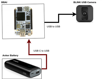

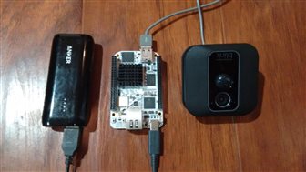

_Beagle Bone AI
_Logitech camera
_Anker Battery

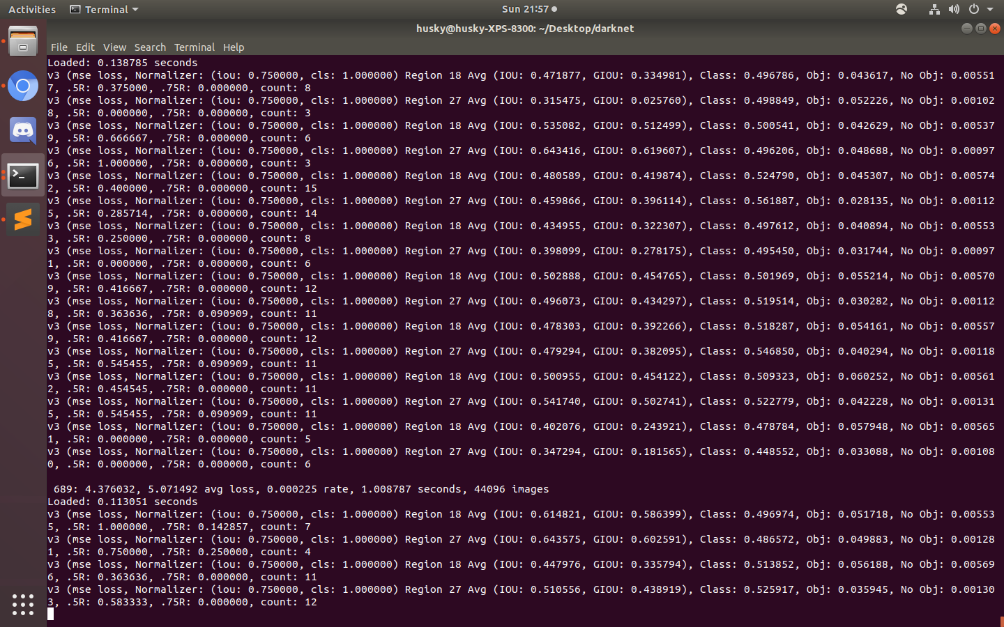

6. Finally , use the following command to start training your model. There should be an already pre-trained model in the Darknet directory. You are simple retraining with new data.
./darknet detector train BBAI/BBAI.data BBAI/BBAI.cfg BBAI/darknet53.conv.74
It recommend to train around 9000 iteration , but in some case around 7000 or even 5000 iterations would yield better result. Since i modified Darknet to save the model every 1000 iterations. It should be fairly simple to test and see which iterations have the best result.

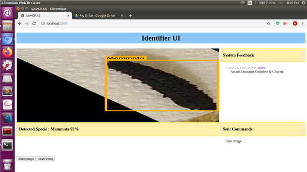

To make enabling image capturing and detection simpler. I make a local webapp using nodeJS to control this application remotely.
The app.js create a webserver to host the webpage. To access the webpage you simply just type in localhost:5000 in the url.
This is the control UI
Full Repo : https://github.com/Husky95/BBAI
