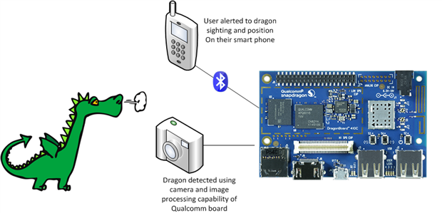

My initial entry was as follows:
This remarkably got me into the competition so they sent me a DragonBoard.

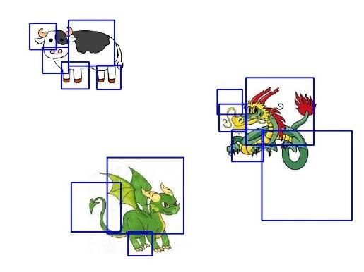

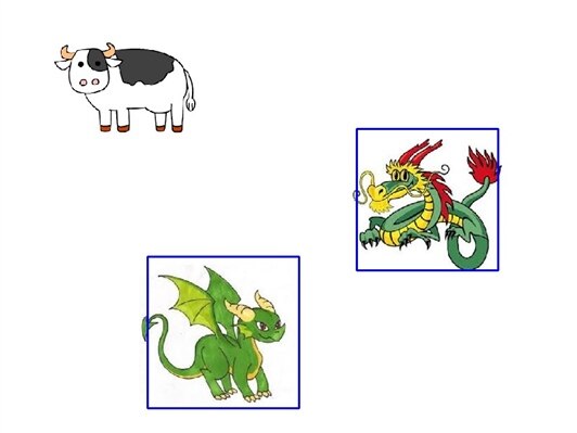

I then set about training the system to regonise dragons. My first experiments performed badly but it eventually got to the point where it could detect them.
I then set about getting the hardware sorted.

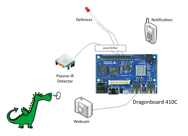

I added a PIR detector, WebCam and some LEDs for output, using GPIO and a level shifter to connect the 1.8v logic levels to work with the detector and LEDs.

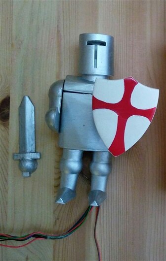

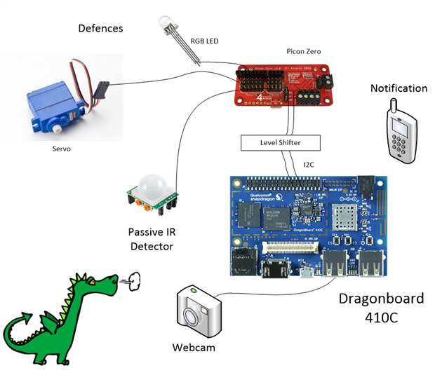

I wasn't that happy with the cardboard knight as I really wanted to have some movement. So I designed a 3D printed model and printed that out and painted it. At the time the DragonBoard did not support PWM outputs so I switch to a Picon Zero board to handle the I/O and communicated to that using I2C.

On reflection there's a few things that could be improved with the project. The web camera was of very low quality so that could do with an upgrade. Also the training as shown above was done with a white background, that should have been done with a more diverse range of backgrounds to give better detection and preferably should have been done with the webcamera providing the images. As with the face detection, it might have been better to detect "animals" with a generic classifier then within that frame, look to see if the animal was a dragon.
