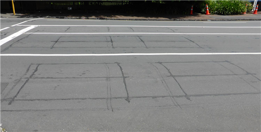

Vehicle detection loops, called inductive-loop traffic detectors, can detect vehicles passing or arriving at a certain point, for instance approaching a traffic light or in motorway traffic. An insulated, electrically conducting loop is installed in the pavement. [1]
Vision based loop sensor requires no pavement cut. I can add/remove/modify loop sensor whenever i need it.

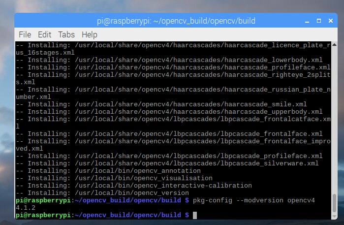

OpenCV

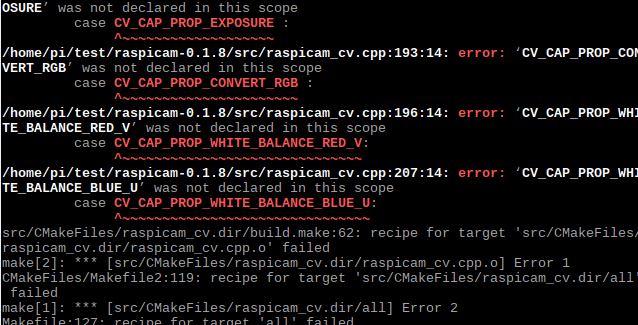

This is challenge one. Initially i thought of using python opencv, easy installation. install dependencies, and pip install will do the work for me.
But I keep getting error message "ImportError: numpy.core.multiarray failed to import" when i import cv2.
Tried many ways and cant get rid of it. Update numpy, upgrade python, change different version opencv, no luck.
finally, i decided to recompile and use c++ instead. took me hours to compile it.
https://linuxize.com/post/how-to-install-opencv-on-raspberry-pi/

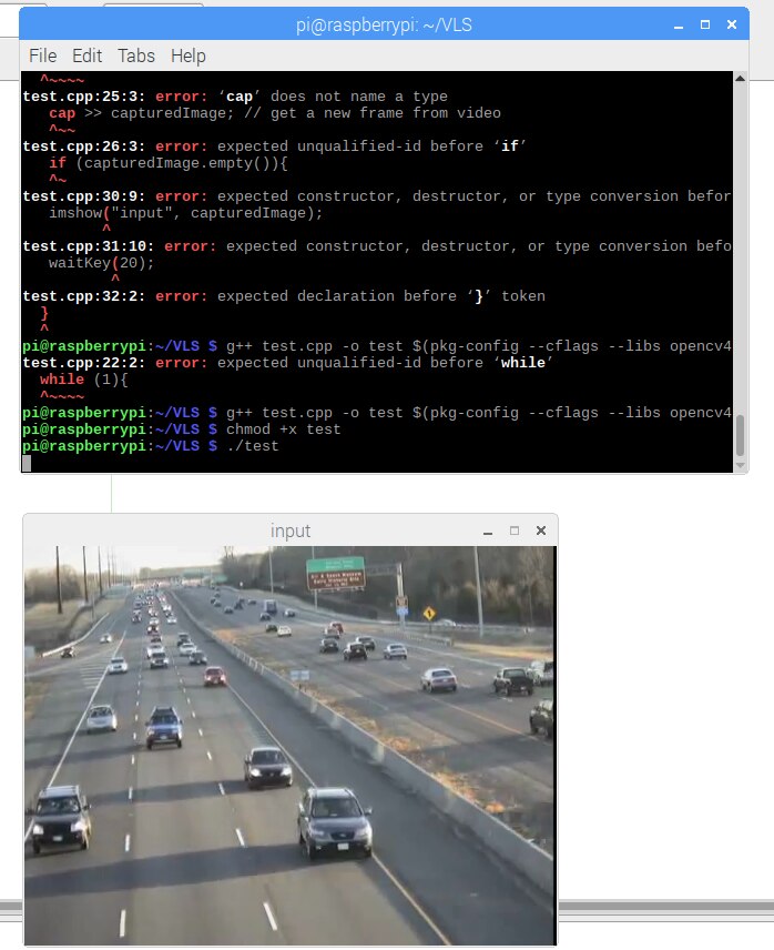

Simple Program
initial plan was to record live video from junction. but frequent raining days make it difficult. alternative is to search google for traffic video.
I wrote a simple program to playback video.
to compile code with opencv lib, use following. change binary file permission before running.
g++ test.cpp -o test $(pkg-config --cflags --libs opencv4)
chmod +x test
./test
program to play video

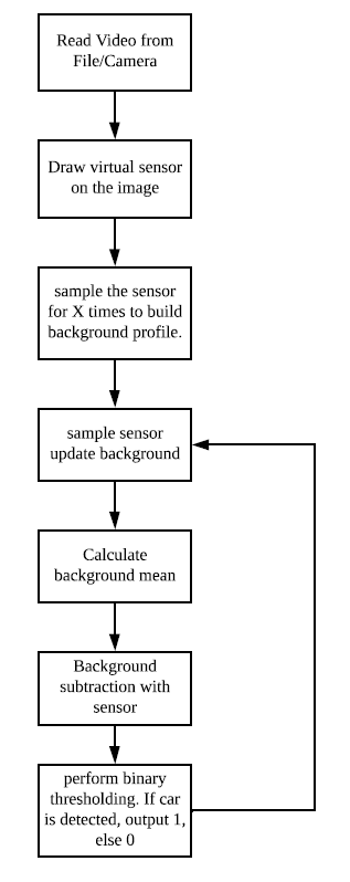

The idea is simple, background subtraction. given a line sample long enough, i can have the average value of the background.
Whenever there is vehicle passby, it will cause pixels value change, and detection is done based on these changes.

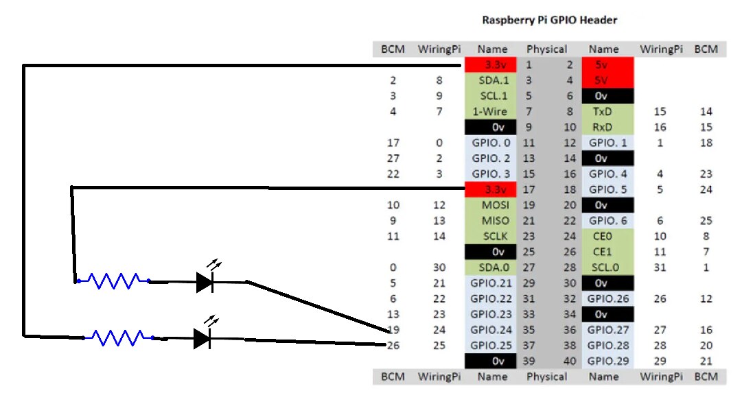

Multiple Sensors and LED Indicator

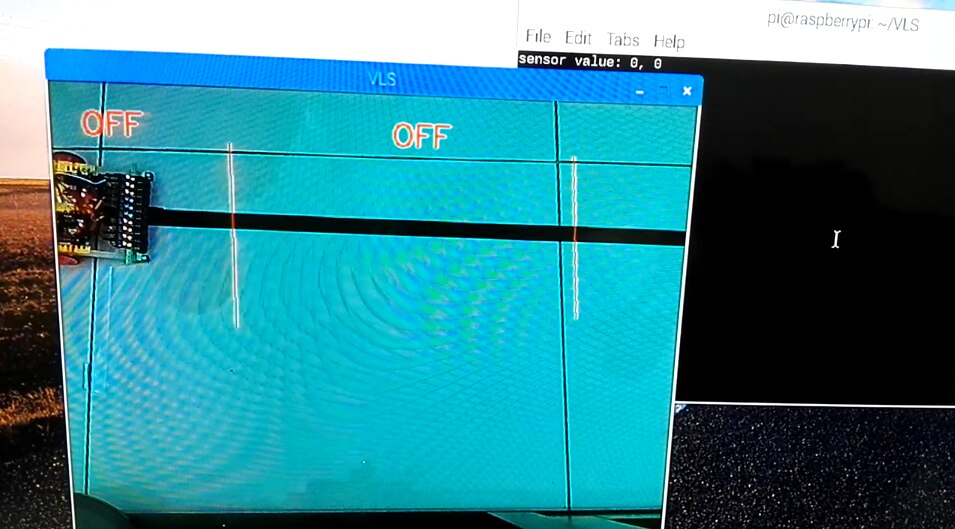

added multiple sensor option. can add more sensor, it is define at the beginning of the program.
the idea is simple as well, do the JOB for SENSOR_COUNT times using for loop.
the more sensors are added, the slower is the process.
#define SENSOR_COUNT 2

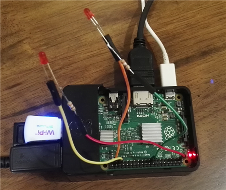

connect 2 leds as indicator to GPIO24,25. The sensor status is shown on screen + led. below is schematics.
Red LED with 390ohm resistor, active low.
it took me a while to realise BCM pin mapping is difference from WiringPi.
I am using wiringpi to control gpio. it is easy to use, and syntax is similar to arduino.  it is also preinstalled in raspberry pi.
additional flag is needed to compile program with wiring pi.
g++ main.cpp -o main $(pkg-config --cflags --libs opencv4) -lwiringPi
Blink | Wiring Pi
Output Video
Source Code

        if (detectionResult[0]){
            putText(temp, "ON", Point(30, 50), FONT_HERSHEY_SIMPLEX, 1, Scalar(0,0,255), 2);
            digitalWrite (24, LOW);
        else{
            putText(temp, "OFF", Point(30, 50), FONT_HERSHEY_SIMPLEX, 1, Scalar(0,0,255), 2);
            digitalWrite (24,HIGH);
        if (detectionResult[1]){
            putText(temp, "ON", Point(330, 50), FONT_HERSHEY_SIMPLEX, 1, Scalar(0,0,255), 2);
            digitalWrite (25, LOW);
        else{
            putText(temp, "OFF", Point(330, 50), FONT_HERSHEY_SIMPLEX, 1, Scalar(0,0,255), 2);
            digitalWrite (25, HIGH);
        imshow("VLS",temp);
        waitKey(1);

Seach google for C++ raspicam library, this is the first appear.
https://www.uco.es/investiga/grupos/ava/node/40
get the latest source file and follow the instruction to install raspicam.
For opencv4, you will get plenty of XXX was not declared in this scope errors.  This is due to capture properties no longer begin with CV_ in opencv4, and raspicam is written based on opencv3.
workaround is to change all CV_CAP_XXX into cv::CAP_XXX in raspicam source file. There are 4 in total:
src/raspicam_cv.cpp
src/raspicam_still_cv.cpp
utils/raspicam_cv_test.cpp
utils/raspicam_cv_still_test.cpp
to compile the program with raspicam, flag -lraspicam_cv is needed.
g++ main.cpp -o main $(pkg-config --cflags --libs opencv4) -lwiringPi -lraspicam_cv

Demo with Line Following Robot
the demo is done with line following robot. duct tape on the floor, form a loop and the robot will be running forever.
the camera is mounted (in exact, i tape it) on the printer, and looks at the floor.
