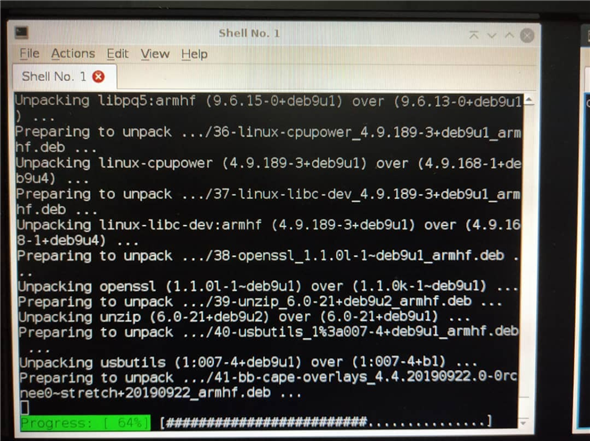

I face a not enough space left on device after attempting to do sudo apt upgrade on the device.
the same scenario happen if i try to update the cloud9 by pulling by following example in https://beagleboard.org/upgrade
i also try to follow https://www.hackster.io/175809/tidl-on-beaglebone-ai-1ee263  but all of these will fail at the same 'not enough space scenario'
originally i thought the 8GB sd card i use is really insufficient then i change to a much bigger one and realize problem persists....then it must be something wrong
below is my sudo apt update and the subsequent sudo apt upgrade procedure

E: You don't have enough free space in /var/cache/apt/archives/.

    mp2100 over 7 years ago in reply to weiwei2 +3 verified
    Wei, you had an 8 GB card, but the downloaded image is a 4 GB image. You found the manual instructions to expand the image to fill up your 8 GB card. On that page https://elinux.org/Beagleboard:Expanding_File_System_Partition_On_A_microSD…

    i have found this page https://elinux.org/Beagleboard:Expanding_File_System_Partition_On_A_microSD and follow it. originally, my SD is /dev/mmcblk0p1 8192 7372799 7364608 3.5G 83 Linux after the successful…
    after the successful repartioning mine is
    /dev/mmcblk0p1 8192 15384575 15376384 7.3G 83 Linux
    the only difference is that after the step 7, and accept the default options for 2 times, i reach a this, and enter n
    Created a new partition 1 of type 'Linux' and of size 3.7 GiB.
    Partition #1 contains a ext4 signature.
    Do you want to remove the signature? [Y]es/[N]o: n

    1. sudo su
    2. fdisk /dev/mmcblk0
    3. d
    4. 2
    5. n
    6. p
    7. 2
    8. n
    9. w
    10. reboot
    11. sudo su (after reboot is complete)
    12. resize2fs /dev/mmcblk0p1
    • Reject Answer
  • weiwei2
    0 weiwei2 over 7 years ago in reply to weiwei2
    it is working.....although i wonder why in the first place the official image is not configured to have sufficient space
    at the top, they give the automatic instructions.
    Existing on the beaglebone, there's a script that does all those steps for you,  "grow_partition.sh" you just have to run that script and it's done.
