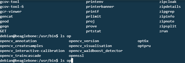

After several days into attempting to install OpenCV on my BB-AI it feels like I'm at about 0:15s into this video !
https://www.youtube.com/watch?v=wmFzGXy5uYc
Maybe some pointers for others are in my iBox posts:
iBox: #2 Setting up the BB-AI
iBox: #3 Is it a cat, a plane, a moth?
I also tried cross compiling on my faster PC with the aim of porting the code across afterwards, but that too failed with the libpython2-dev:armhf library not being found. After much adjustment of my machine on the Linux command line I'm also no nearer on that approach.
But it did make me think, hence this question rather than a blog post:
If I were to compile the OpenCV on my other machine and port it across to the BB-AI then has someone else done this? e.g. why am I sitting waiting days for the BB-AI to run CMAKE if it could be done externally and highly likely someone already has.
I've learnt many Linux commands along the way and have a rough understanding of what cross-compiling is.....so progress todate has been worthwhile still image

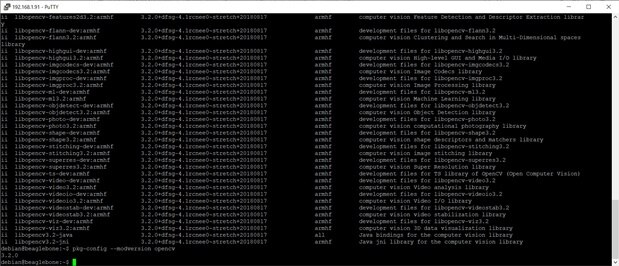

    0 vlasov01 over 7 years ago in reply to shabaz
    Hi there,
    I've run in out of memory situation during compilation on BB-AI. If you get the same issue, than you will need to create a swap.space. I was following the following document: https://linuxize.com/post/how-to-add-swap-space-on-debian-9/  to accomplish it..

    0 skywalker1211 over 7 years ago in reply to 14rhb
    there is no error message. i got the same problem when i compile opencv4 in raspi2. increase swap space solve the problem.
    https://linuxize.com/post/how-to-install-opencv-on-raspberry-pi/    --->   "Start by increasing the swap space to avoid compilation hangups due to memory problems:"
    • Reject Answer
  • 14rhb
    0 14rhb over 7 years ago in reply to skywalker1211
    Thank you for this useful information skywalker1211 - do you have any recommendations for what you changed the swap space to?
  • skywalker1211
    14rhb
    i changed from 100 -> 1024, and revert after installation.
