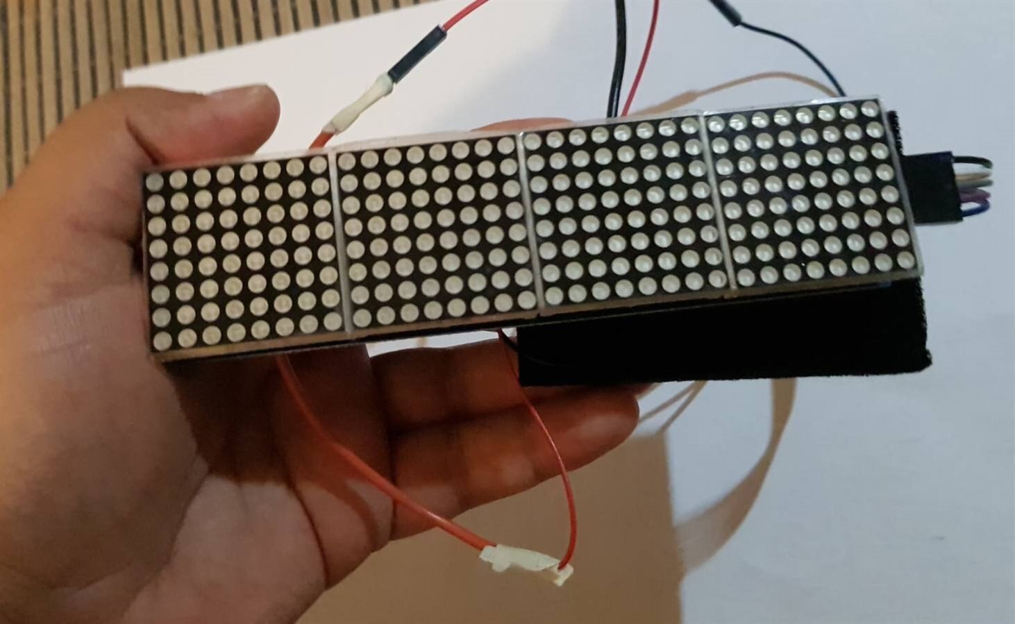

I have often wondered about the small ways in which we can re-use the electronics and waste less paper. I had an idea as of why not use less bulky electronic name tags which are easily rewritable and can be re-used by re-programming the display. So I decided to jump in last minute into this challenge by making one for myself which I can use in the future.
The components

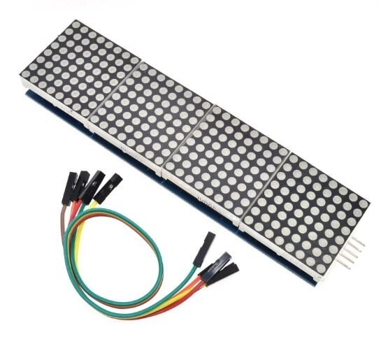

  • MAX7219 Dot Matrix Module For Arduino

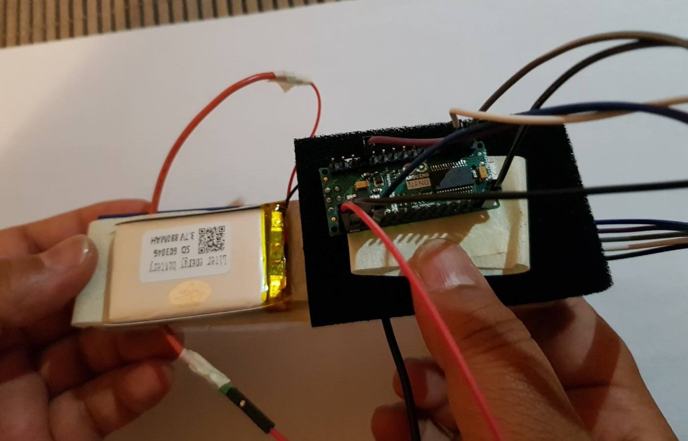

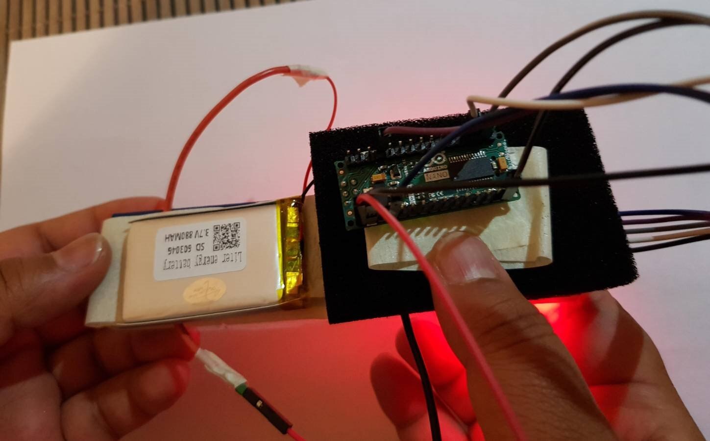

  • Adruino Nando as it is small and portable
  • A small portable battery.
  • With some Arduino code
Four MAX7219 Dot Matrix Module

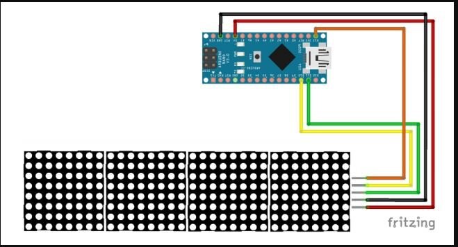

Connect them to the Arduino Nano using SPI bus DIN and SCLK. The LED matrix needs high voltage bias

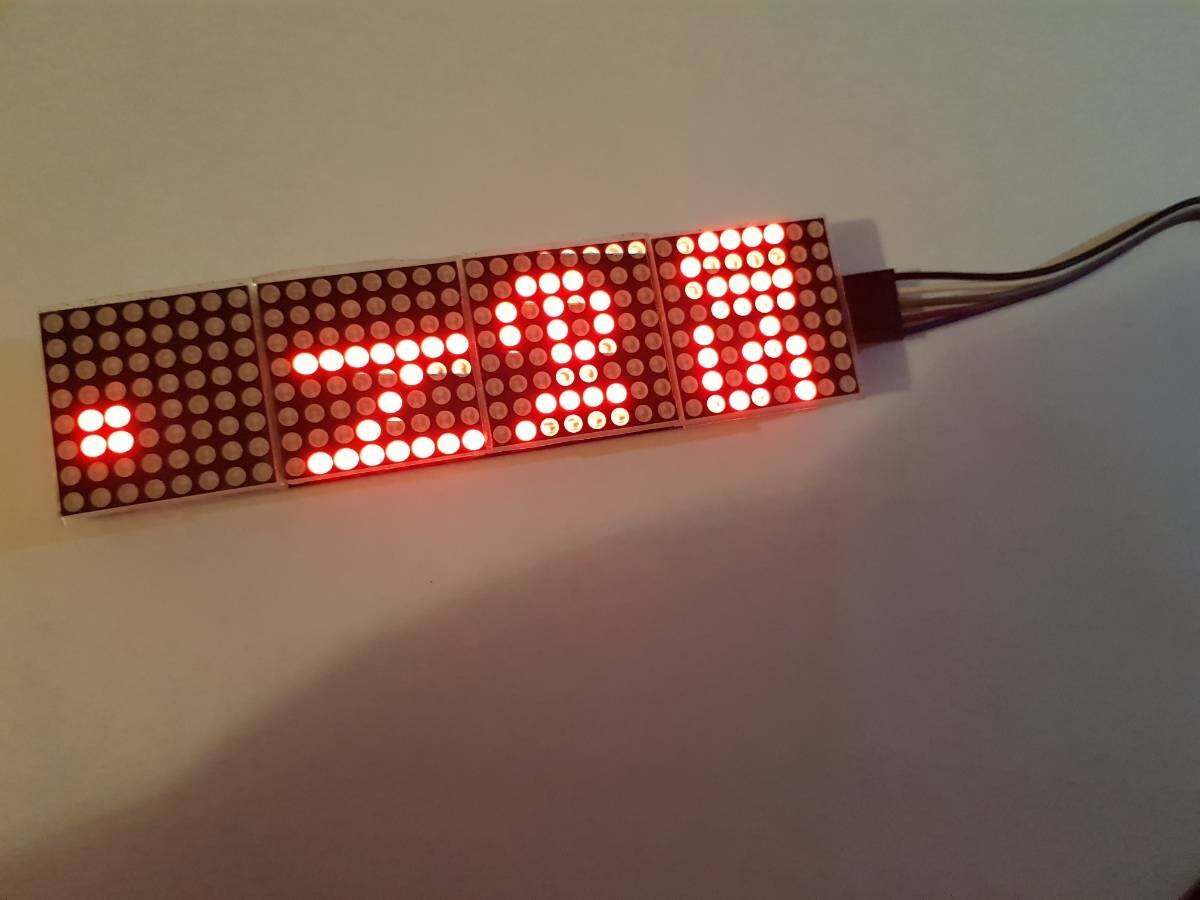

Testing the first prototypes

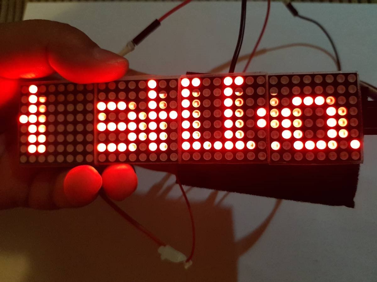

Displaying Hello World and Welcome in the Dot Matrix
The final working Video

    Hi Dixon, Yes the image is reversed on purpose so the correct image can be seen when you put it on or also in the camera. It is for other to read it correctly and reversed for self. Cheers
