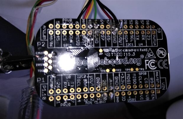

  • PocketBeagle comes with USB mini port, but it doesn't have expansion headers, and DC plug. I realized that it requires some soldering to connect sensor and battery.
  • There are a lot of projects and code samples available for BBB. Most of them can be used with PocketBeagle. But PocketBeagle has a bit different pin-out compare to BBB. So some adjustments of code and connectivity is required.

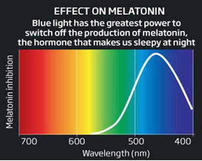

One of his points is the effect of the blue light on sleep. Melatonin helps trigger sleep in humans..Blue light has a very strong on melatonin inhibition.
Blue light effect on melatonin

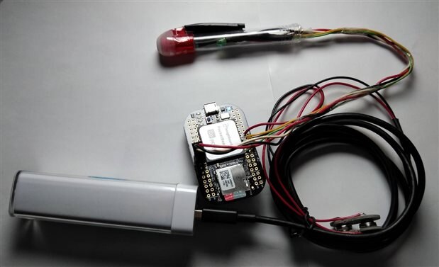

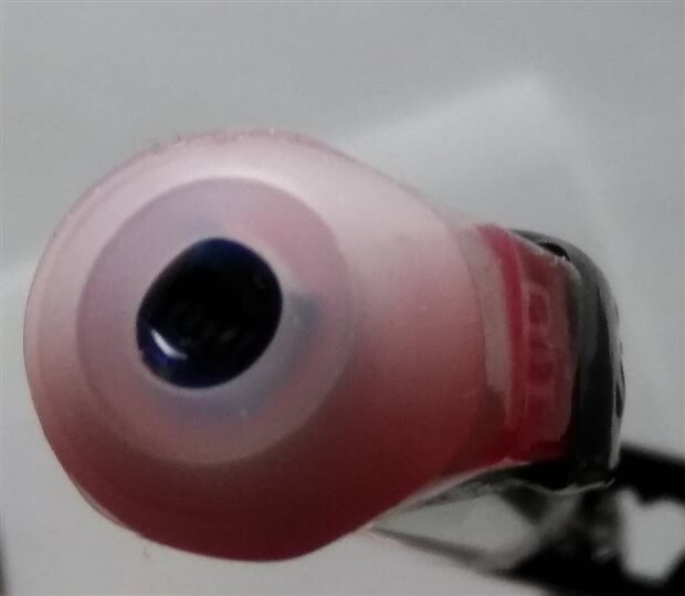

I was looking for something to embed light sensor, so it can be wearable, but not too big and not look super nerdy like Google Glass. Pen seems to be a good option.It can host a photoresistor and a LED indicator.USB battery is quite big compare to everything else. So it is a good candidate to be replaced with something smaller.
PocketBeagle with light sensor design
Assembled sensor with LED inside a pen.
Assembled sensor,  PocketBeagle and battery in my from pocket
Assembled sensor - view from top with blue light filter.
Assembled components.
Assembled PocketBeagle Board view from the top.
Assembled PocketBeagle Board view from the bottom.
There is less light in horizontal position of the sensor. As result LED is off. When I turn it into vertical position, there is more light (including blue light) and LED gets switched on.

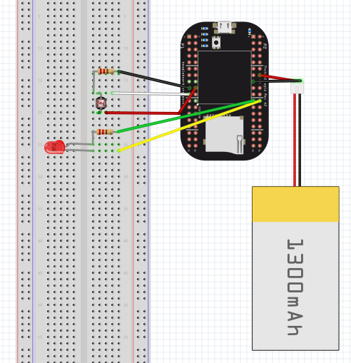

Fritzing PocketBeagle schema
Components
Electronic Components
PocketBeagle Board
LED
Photoresistor
Resistors - 1K, 10K
USB battery
USB cable
Wires
Connector
Header extensions

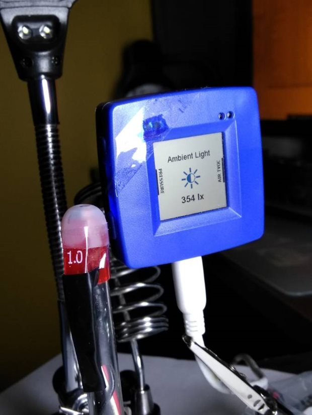

I've a NXP Rapid IoT node. It has several sensors including light sensor, During the test I've set both devices next to a light source (Varilux Comfort Lens VT15 - CFML36VLX - 2500 lumen) using my soldering station and applied the same blue filter for both of them. I've oriented NXP device to represent a head and my wearable sensor simulated position in the front pocket.
CFML36VLX lamp light is evenly distributed according to its manufacturer. So blue light is taking ~1/3 of visible light spectrum.
.image
My NXP device measured 354 lx At the same time I've got the following GPIO readings from PocketBeagle:
0.0678876712918
0.0686202719808
0.0688644722104
0.0693528726697
0.0691086724401
