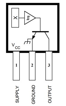

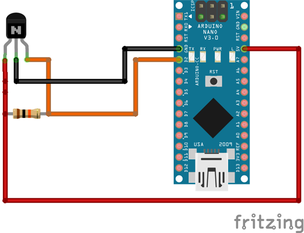

Hall Sensor - First Test
     By looking through a lot of tutorials I saw a few different approaches. Tested out a lot of them, but most didn't do for me what I wanted. I saw a lot of people also using interrupt pins which I wanted to avoid if I could. So in the end the method which proved to work perfectly for me is this which requires a single 10K resistor for each hall sensor. Here is how the connection looks like:
In this configuration, the sensor worked precisely as I wanted to, which is like a small button. With this part finished all that was left is to make a small board with 9 of these soldered to it, so that will be my next step in this build.

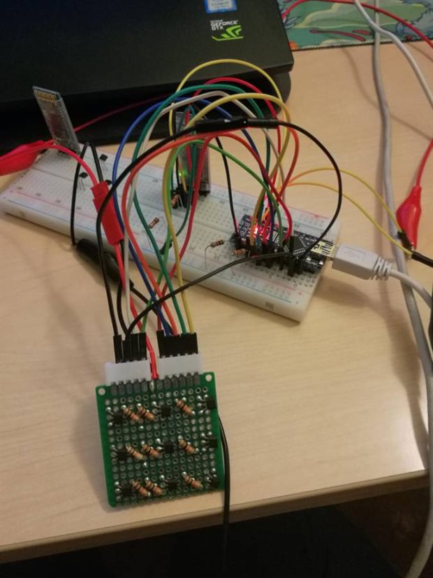

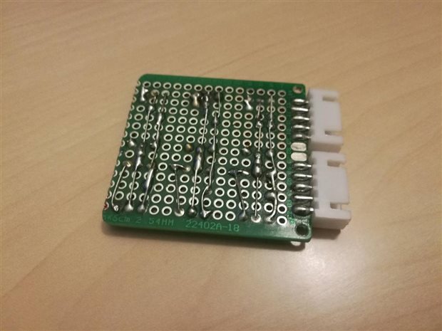

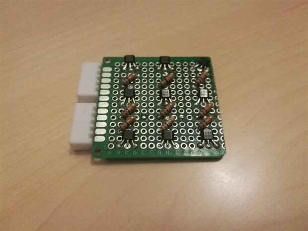

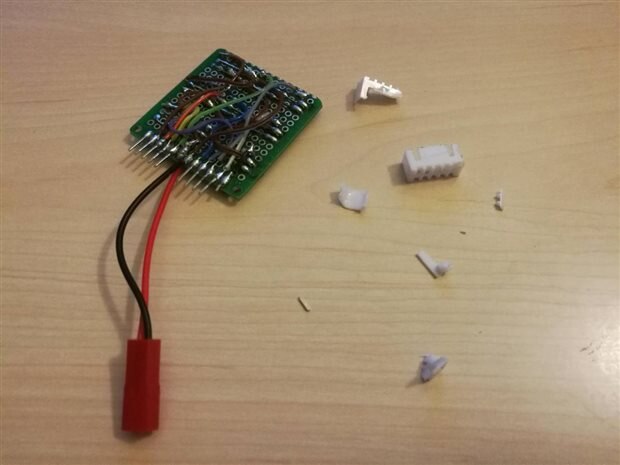

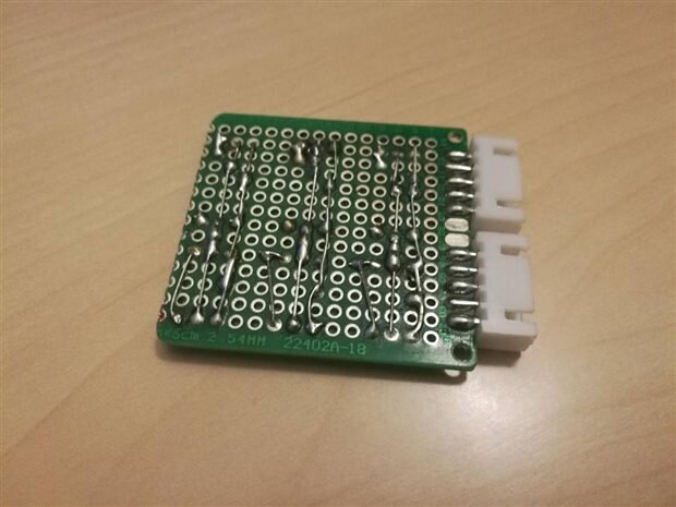

Making the 3X3 Grid
     For the most part this was a pretty straight forward build with only 2 things to consider and that is what kind of connectors to use, which turned out to be only one option that I could find locally, as well as the size of the board itself. The goal was for the user not the notice that there is anything in the glove, but also I didn't want to make it impossible to use. By putting different sized board in one of my gloves which I picked for this project, I ended up with the size of around 4x4cm. I couldn't feel the board at all, but it also looked like pretty easy to use. So here is how the soldering process went:
{gallery} Hall sensor grid
Top Side: The top side of the board came out really clean
Bottom Side: This is the bottom side before all of the connecting wires we put
Finished grid: 8 out of 9 sensors worked perfectly, while one of them wasn't responding as it should. All of the connections are fine, but it possible got damaged from me heating it too much, or it didn't work from the beginning since I didn't test them all at the start.
That would wrap up building the small grid, next thing to tackle would be Bluetooth.

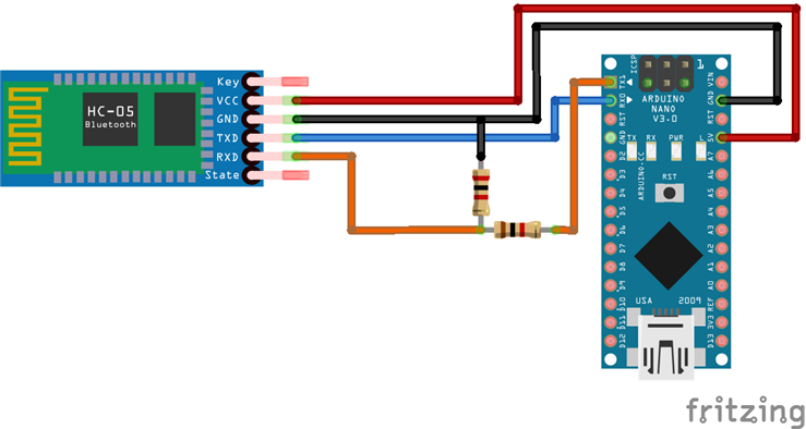

Bluetooth - Arduino Side
     The obvious contender for this would be the HC-05 or HC-06 Bluetooth module and I went with the HC-05. I've worked with module before so I thought it would be a simple straight forward job, but boy oh boy was I wrong. I connected the HC-05 using a voltage divider on the module RXD pin, since the board requires 3.3V for communication and downloaded a few different apps to test out if everything worked. It didn't. Using my phone I could see the Bluetooth device, and pair with it, but as soon as I tried connecting to it in any of the apps (which worked for me before) I would get an error could not connect to device. I spent hours upon hours of trying to troubleshoot this, went through all of the commands on the Bluetooth module, which all gave me responses that the module worked correctly. I went and bought a new Bluetooth module HC-06 not even thinking about it could be a problem with the phone. Tried the new module, same as with the old one. Then finally I tried troubleshooting the phone where everything seemed fine, but the things is, other phones were connecting properly to the modules without a single problem. I went and deleted all of the apps that had anything to do with Bluetooth on my phone, and that did the trick! The moment I saw the firs byte of data come from Bluetooth I was extremely happy knowing that I can actually continue on with the project! I still don't know what caused the problem but everything works great now. Here is how I connected and how I established communication between the Bluetooth module and the Arduino.
The voltage divider is made out of a 2K and 1K resistor. Communicating with the Bluetooth module HC-05 using an Arduino is really simple, since the module is connected to the Serial pins on the Arduino, all we need to do is read and write to the Serial to communicate with the module. The baudrate can differ from module to module, by reading the datasheets on these modules, most of them are in mode for accessing their commands at 38400, and for communicating at 9600. For the module that I own the baudrate that works is 38400, so that is just something to keep in mind if it doesn't work straight up. Also another important thing is to disconnect everything from the Arduinos RX and TX pins when uploading the sketch, or the upload will hit an error.

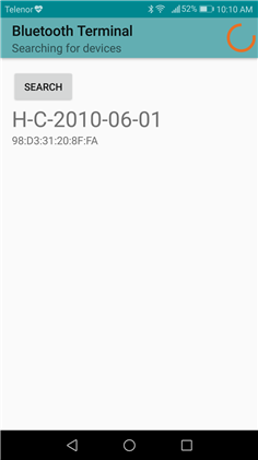

Bluetooth - Android
     A few years go a friend and I had a project which included Bluetooth for Android and no matter what we did, we couldn't get it to work properly. I've looked around the net now and found this https://github.com/MEnthoven/Android-HC05-App.This was made by Maarten Enthoven, he did a really exceptional job of making an app that find, pair, connect to a Bluetooth device, and send/receive data and furthermore he put the whole source code on GitHub so anyone can see and use it. So I want to begin this part by saying thanks to him, because this made everything so much easier. I downloaded and ran his code on my phone, and it worked instantly without any problems, I could send and receive data over Bluetooth! That would wrap up the part that utilizes Bluetooth so all that's left is to merge the 2 into one.
     To merge the 2 into one all I did was build on top of the working Bluetooth app. Since Arduino will be doing all of the gesture interpretation, all the app has to do is read the code sent by the Arduino and perform the given function wheter that's adjusting volume, or changing a song. To do this I went through the Bluetooth app code and found the place which to me looked like where the received message was printed out on the screen. I intercepted the message before printing and checking if the value matches some of the gestures I wanted, and then just did the function if it did. I put my code in BluetoothActivity.java in public void handleMesssage(Message msg) in the case Constants.MESSAGE_READ:, here is how that looked like:

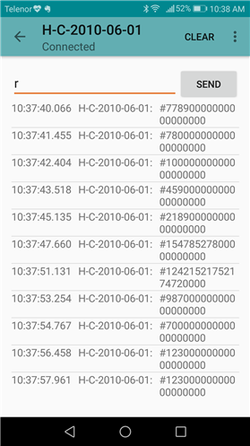

Test
     All that's left to do now is test out how everything works. I powered up the glove, started the app and here are the results I got:
As it can be seen in the Android code, the #123 is next song, #321 is previous, #741 is volume up, #258 is volume down and #987 is media button. Everything worked great and as expected! Here is a picture of the glove (which I managed to cut slightly on accident while putting the components in), the small green dot that can be seen is the HC-05 LED.

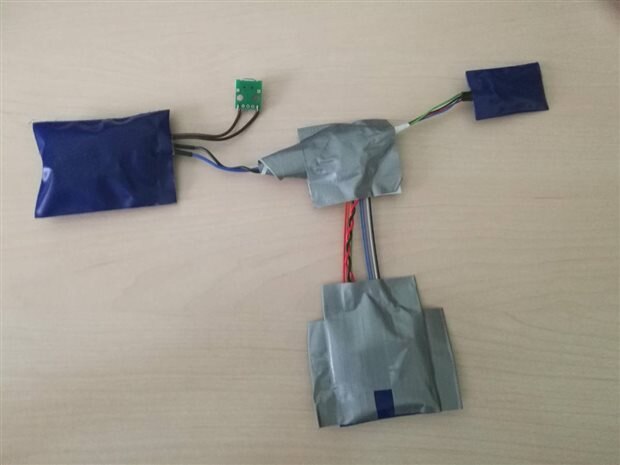

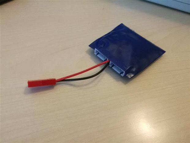

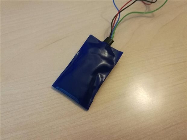

Waterproofing

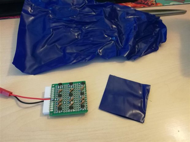

     Since these are gloves at the end of the day, I will be wearing in cold weather for the most part, with of course, the possibility of it raining/snowing. I won't be submerging them in water or anything like that, and in the season when I am wearing them it is usually snowing which is better than if it were raining for electronics. Nevertheless, I wanted to protect the electronics inside the best as I could without compromising the usability and size of the components (going with bulky enclosures etc). Naturally, I tried using some duct tape at first and honestly it worked pretty well but wanted to just add a little bit more, and then reinforce with duct tape if it's needed anywhere. My solution came in the form of an inflatable beach ball. This may sound a bit weird at first, but we are talking about a material which is designed to hold air, so why couldn't it be used to hold water out? With the material sorted the next thing on the list was making enclosures for the components. I experimented here a bit with various different techniques from sewing to gluing, but in the end a mix of many things appeared to be the best option. I found an old bag sealing machine which nobody was using (heats a wire which then melts the bag and creates a great seam). The material I used was a lot thicker than the bags, but it actually turned out great. Here are some pictures of the process:
{gallery} Waterproofing
Material: The small sensor board and the bag I started making for it
Protected sensor board: The sensor board in it's water resistant cover
Protected HC-05: HC-05 in its protective cover
While this doesn't guarantee me any safety, it will be well protected from initial water droplets, at the ends where the wires are coming out I used a bit of double sided sticky tape to try and keep it closed, but will probably add some glue further on. Over this layer I will be adding on some parts a layer of duct tape, since I can sew into it and keep the components from moving around. That would be the first of the things addressed in the second prototype, next on is the power supply for the device.

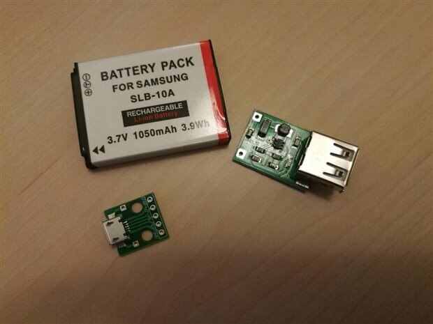

Battery & Charger

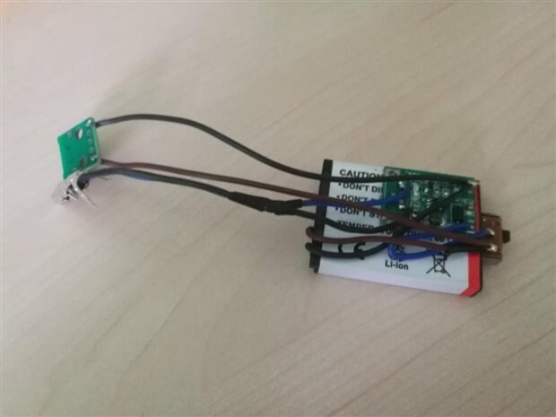

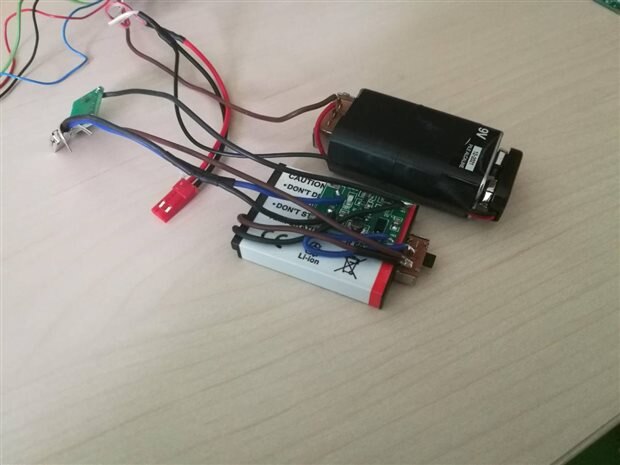

     For the first prototype I used a pretty bulky 9V battery, which worked great, but it's size and the fact that you can't charge it meant I had to change it. Instead of that battery I opted out on using one of the spare batteries I have for my old action cam. It's a 3.7V 1050mAh Li-ion battery. I already have a charger for it, but I had to modify it for charging the glove, which I will show soon, and besides that I added a small circuit to regulate the voltage at 5V as well as a micro USB port which will be used for charging with the circuit.
Disclaimer: To connect everything I soldered the wires directly to the pads of the battery which can be very dangerous! I worked with what I had and don't recommend or advise anyone doing this!
I connected everything, removed the big USB port, and added a small switch between the battery and regulator circuit. After that I added the water resistant cover and ended up with this:
{gallery} Battery
Components: The battery, micro USB port and the regulator circuit
Everything connected: Assembled battery
Comparison: Comparison with the 9V battery, while it doesn't look like a big of a difference in size, it is significant, because the new battery is much thinner which was the problem with the first one, and of course this one can be charged
Finished battery: And here is the battery with the water resistant cover, one thing I am thinking about is maybe adding a small switch for charging, so if the water gets into the connector, which I wont be able to protect that good, the battery won't be ruined.

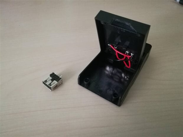

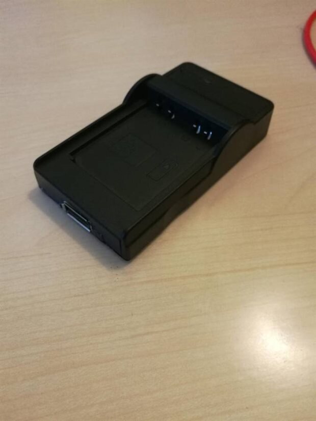

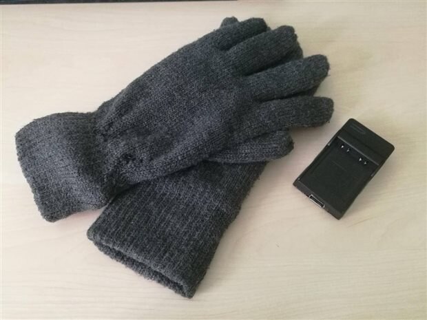

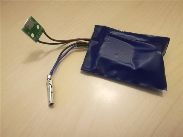

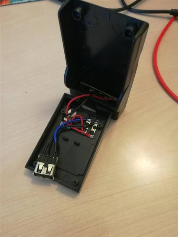

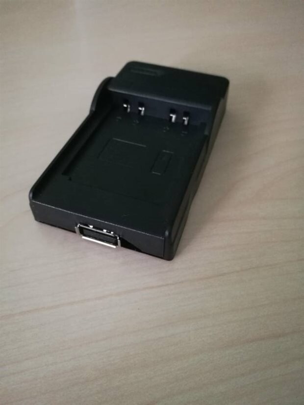

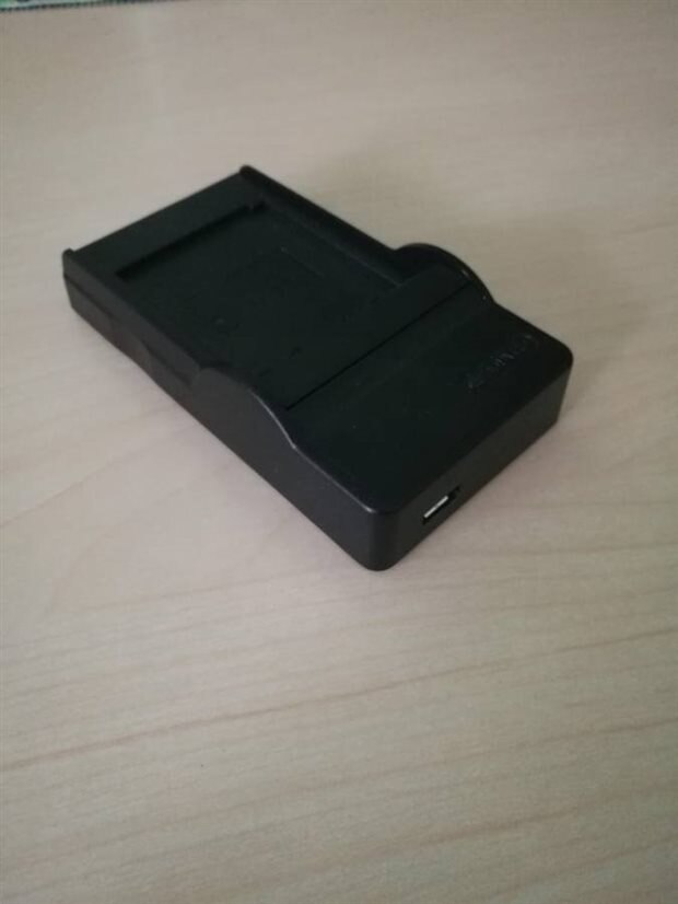

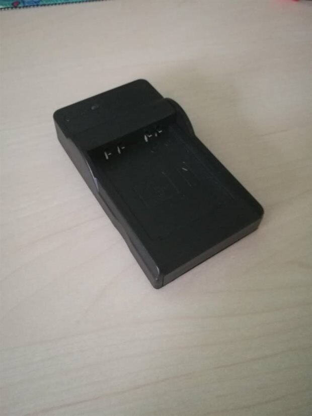

That would wrap up the battery part, all that's left is to modify the charger that I have for these batteries.
The charger itself works by connecting it to a standard 5V phone charger via micro USB. To modify it so I can use it for the gloves as well I've added a USB port to the output of the charger so I can connect it to the battery module using a standard cable, here is how that went:
{gallery} Charger
Stock Charger: This is how the stock charger looks like without me having done anything to it
Stock Charger: The other side of the stack charger, where the USB cables comes in from the phone charger
Modded charger: Not so carefully with side cutters, I made a hole big enough to fit the USB port
Internals: A piece lifts up revealing the contacts that go to the battery, the circuit itself is in the other compartment of the charger which I didn't open because I didn't really need to
Soldering: I just soldered 2 wires on the inside and connected them to the USB port
Assembled: Here is how the assembled charger looks like, I put it back together with the screws it came with, with a little help of hot glue to keep the USB port from moving around when plugging in and out the cable for the battery module
