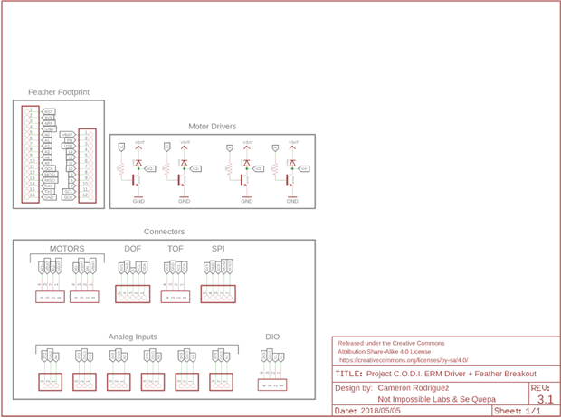

/* ESP32_TOF_VL5130_USRF
 This code is based on the four ""SingleRanging" examples in the VL53L0X API.
 The range readings are in units of mm and the Pololu library example
 Written By:
 Cameron Rodriguez
 cameron@notimpossiblelabs.com
 Last Modified:
 May 2nd, 2018

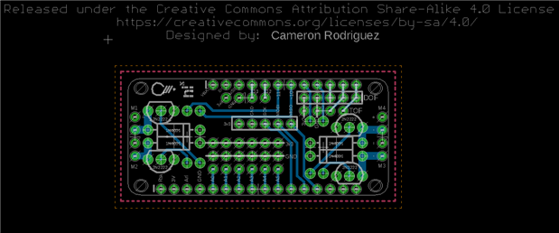

Parts from:
Product NameManufacturer Part Number
Quantity
Part Link
Transistor NPN T0922n2222a1Buy NowBuy Now
Diode1N40011Buy NowBuy Now
Resistor 180Ω
180Ω1Buy NowBuy Now
Parts From:
Quantity
TOF Sensor33171
US Sensor9841
ESP32 Feather
34041
Female Header Pin28861
2000mah LiPo20111
Additional Parts:
Quantity
Haptic MotorJinLong Machinery Z7AL2B16920824
Custom PCBOSH Park1
Wrist BraceMueller 74676862729
