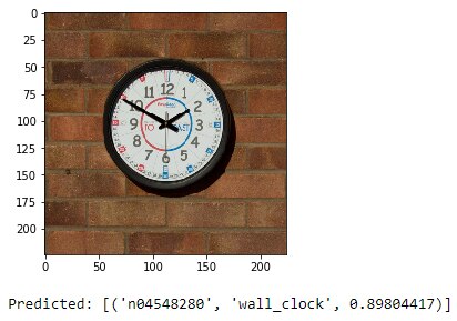

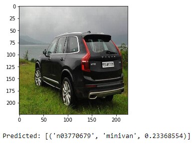

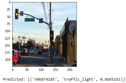

So, naturally, for our requirement, we turned to one of the most famous resnets available- the ResNet-50. We used the model to predict a few outdoor objects:

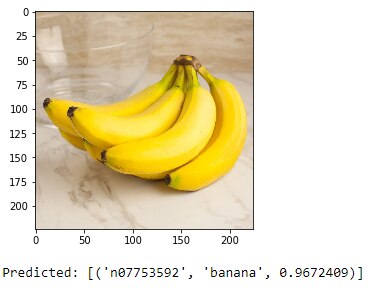

As well as some indoor objects:
And it is working as expected.
