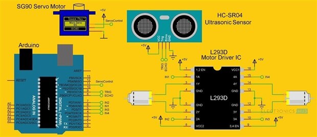

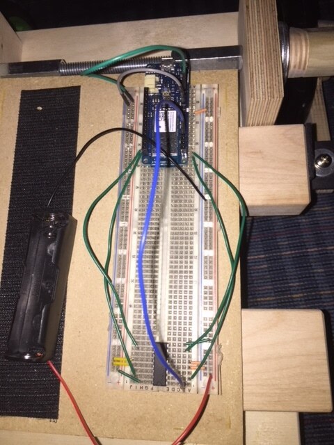

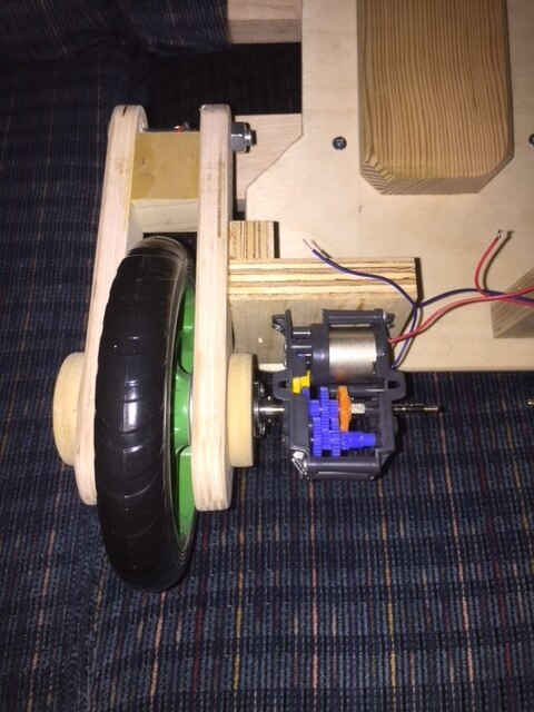

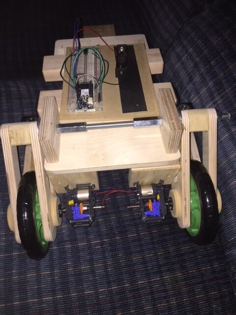

For my 4th blog I will be showing how I attached the motors to drive the robot as well as the wiring I started for the Arduino.
For the motors, I picked up a couple of kits with gears so I can get the speed down and torque up. The gear ratio is 505 to 1.
The motors will be driven by 2 - 3.7v batteries and the Arduino will be powered by a 5v battery pack.
The motor controller is set up as per the picture below (Picture is from the Electronics Hub). Followed by photos of how I have it set up. The motors aren't connected to the driver yet, that will be the weekend project.

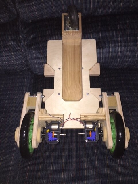

So far the chassis has changed in design. I changed it from 4 wheels to 3. I found this is more efficient and will have better control for the user.

    genebren over 8 years ago +3
    Nice update on your design challenge project. I really like the rear wheels for your robot. Are those scooter wheels? I use to like to use inline skate wheels for my robot platforms, as they were available…
    Nice update on your design challenge project.  I really like the rear wheels for your robot.  Are those scooter wheels?  I use to like to use inline skate wheels for my robot platforms, as they were available in several different durometer (hardness) so you could adjust your traction, they had great bearings and they were very affordable.
    Nice work!
    Gene
