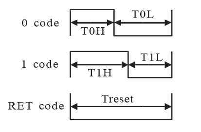

Let us assume that I want to create a signal like this:
Where:
Signal
Name
Duration in
μs ± 150 ns
T0H0.4
T1H0.8
T0L0.85
T1L0.45
Treset> 50
The usual way to generate arbitrary signals is called "Bit banging". It requires software to set the output in the "HIGH" and "LOW" state in the exact timing given by the protocol. The timing requirements for this signal look pretty strict that I do not believe that this would be possible or at least not very reliable. So I am looking for some hardware support.

Let's look at the signal again:
  • it starts always with "HIGH" and ends with "LOW" (except for reset which is always "LOW")
  • length of signal is 1.25 μs (reset again an exception)
  • 0.05 μs resolution (0.05 is the greatest common divisor of 1.25, 0.4, 0.85 and 0.45)
Exact Solution
The signal can be generated with PWM of 1/0.05 μs = 20 MHz frequency. Therefore the "alphabet" above translates to:
SymbolDuty %
"0"32
"1"64
The PWM frequency of 20 MHz is quite high, can the signal be done approximated with lower frequency?
Reasonable Approximation
The odd thing about the spec for this signal is that it is not symmetric, i. E. the high time for "0" is not equal to the low time for "1" as I had expected. Since the rising edge of the signal is every 1.25 μs this allows the receiver to synchronize. The sampling presumably takes place at exactly the half of the time which explains the asymmetry: It gives a safety margin for the timing or rather does not require steep edges.
The tolerance for the falling edge is quite high. I did not recognize it at first sight, but when I converted the whole timing into nano seconds (ns) It's pretty clear:
Signal Name
Time of Falling Edge
Nominal [ns]
Minimal [ns]
Maximal [ns]
T0H400350550
T1H800650950
This allows a much more reasonable approach:
Divide the 125 ns in three sections ad vary the duty cycle between 1/3 and 2/3 or in decimal:
SymbolDuty %
"0"33
"1"66
The frequency in this case is only 2.4 MHz. That's much better!
Reset
The reset symbol is an exception - it does not fit in the above timing. It can be generated by 40 periods with a duty cycle of 0%.

    Not to be picky, but I think your scaling for the mystery signal is incorrect.
    For a 1 on your raw signal the 'mystery signal' does a high and low which together = 125uS (which could be the clock cycle).
    If you excuse the poor cut and pasting, it should look more like this.

    As far as I'm aware, NRZ is not about the voltage levels, its about data.
    I know from playing with these leds that you do require to have the right frequency for data, so here's what I believe is happening.
    Inside is an intelligent chip, that samples incoming data stream.
    They could either compare the data level against a counter to see if it is One or Zero, or just check the level at 1/2 way (ie 62.5uS)
    After counting 24 bits of data, it shapes any incoming and passes anything on the Data_In to the Data_Out pin.
    I'm presuming it also sends the reset to the next pixel ...
    Whatever you set these to will remain when you pull the data line, so you can just run once and then stop the processor if you want.
    Using PWM and setting the ratio is a very clever way to simulate what you need, so well done.
