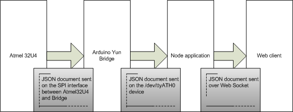

As I like experimenting new approaches to the a problem, I decided to move away from the typical solution based on periodic poll to update the values on the web interface and use web sockets instead. The data flow is shown in picture below
Basically, whenever the Atmel 32U4 has updated data, it sends such data (formatted as a JSON document) to the node application that is listening on port /dev/ttyATH0)
If a client is connected on a web socket, the node application sends the same document on the web socket. Upon receiving new data, web client update widgets accordingly
This is not the best approach from a software-engineering point of view (I broke the separation-of-concern principle as the Atmel32U4 should be unaware of data format used by the web client) but it's quick and easy  to implement and to understand

    I'm not sure you have broken the control separation principle there. The Atmel32U4 knows only of the serial port and sends data down that. If you changed your format for the web client then you'd need to also change the Node application but you would not necessarily need to change the Atmel32U4 code so the separation is still there. Equally if you change the format sent from the Atmel32U4 the you'd only need to change the next level to keep sending the old format to the WebClient.
