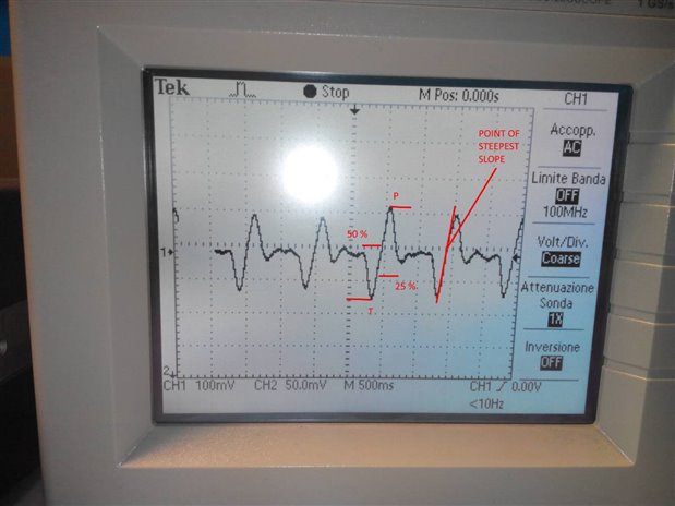

After building the heart beat sensor, it's time to process the output signal to get the actual heart beat
The heart pulse signal that comes out of a photoplethysmograph is an analog fluctuation in voltage, and it has a predictable wave shape as shown in figure below
My goal is to find successive moments of instantaneous heart beat and measure the time between, called the Inter Beat Interval (IBI). By following the predictable shape and pattern of the PPG wave, we are able to do just that.
When the heart pumps blood through the body, with every beat there is a pulse wave (kind of like a shock wave) that travels along all arteries to the very extremities of capillary tissue where the Pulse Sensor is attached. Actual blood circulates in the body much slower than the pulse wave travels. Let's follow events as they progress from point 'T' on the PPG below. A rapid upward rise in signal value occurs as the pulse wave passes under the sensor, then the signal falls back down toward the normal point. Sometimes, the dichrotic notch (downward spike) is more pronounced than others, but generally the signal settles down to background noise before the next pulse wave washes through. Since the wave is repeating and predictable, we could choose almost any recognizable feature as a reference point, say the peak, and measure the heart rate by doing math on the time between each peak. This, however, can run into false readings from the dichrotic notch, if present, and may be susceptible to inaccuracy from baseline noise as well. There are other good reasons not to base the beat-finding algorithm on arbitrary wave phenomena. Ideally, we want to find the instantaneous moment of the heart beat. This is important for accurate BPM calculation, Heart Rate Variability (HRV) studies, and Pulse Transit Time (PTT) measurement. .
Some heart researchers say it's when the signal gets to 25% of the amplitude, some say when it's 50% of the amplitude, and some say it's the point when the slope is steepest during the upward rise event. This version 1.1 of Pulse Sensor code is designed to measure the IBI by timing between moments when the signal crosses 50% of the wave amplitude during that fast upward rise. The BPM is derived every beat from an average of the previous 10 IBI times.
First off, it's important to have a regular sample rate with high enough resolution to get reliable measurement of the timing between each beat. To do this, we set up Timer2, an 8 bit hardware timer so that it throws an interrupt every other millisecond. That gives us a sample rate of 500Hz, and beat-to-beat timing resolution of 2mS. This will disable PWM output on pin 3 and 11

Next, we keep track of the highest and lowest values of the PPG wave, to get an accurate measure of amplitude. Note that this processing will be also useful when we will try to measure blood pressure
    if(Signal < thresh && N > (IBI/5)*3){
      if (Signal < T){
        T = Signal;
    if(Signal > thresh && Signal > P){
      P = Signal;
Variable P and T hold peak and trough values, respectively. The thresh variable is initialized at 512 (middle of analog range) and changes during run time to track a point at 50% of amplitude as we will see later. There is a time period of 3/5 IBI that must pass before T gets updated as a way to avoid noise and false readings from the dicroic notch.

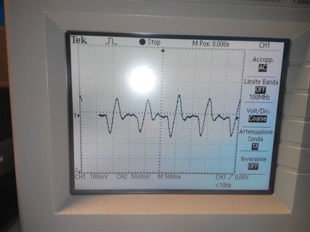

    e14 Contributor over 10 years ago in reply to amgalbu
    Do you mean the output of the pulse sensor? What MCU are you using? and do you have a picture of your circuit?. I was just willing to see how you have designed this.
    Thanks!
  • amgalbu
    amgalbu over 10 years ago in reply to e14 Contributor
    Hi HB
    I connected the scope to the output of the amplifier
    Cheers
    Ambrogio
    This may be a silly question to ask but lets just say you want to analyse the pulse sensor its self and the waveform it produces. Where do you measure to get the output waves on the oscilloscope?
