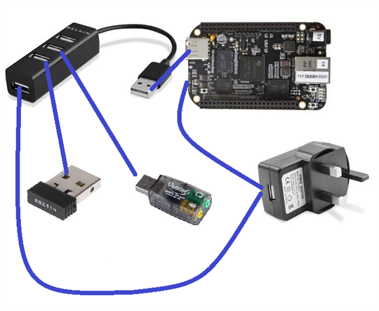

1. BBB as Drum bit MIDI Synthesizer: I will use BBB as MIDI Synthesizer to produce drum sound using either pure data or other Software synthesizer.
low cost USB sound card will be used for provide Audio output from BBB. Low Cost WiFi USB Adapter will be used to provide wireless connectivity between Pedals, Stick to BBB using UDP Protocol.

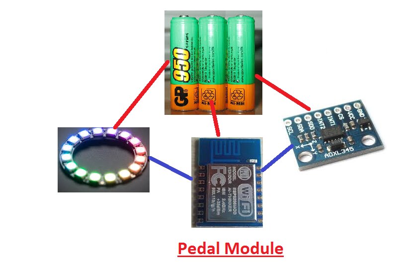

2. Two Wearable Pedal: This will be ESP8266 based shoes attachable module. ADXL345 accelerometer on this module detect pedal kick and velocity of the same which is converted to corresponding MIDI note by ESP8266 and than sent to BBB over WiFi using UDP. Also neopixel leds on this module produce lighting effect based on Pedal kick velocity. The module is powered by Lithium single cell or 3 cell -NiMh Pack.

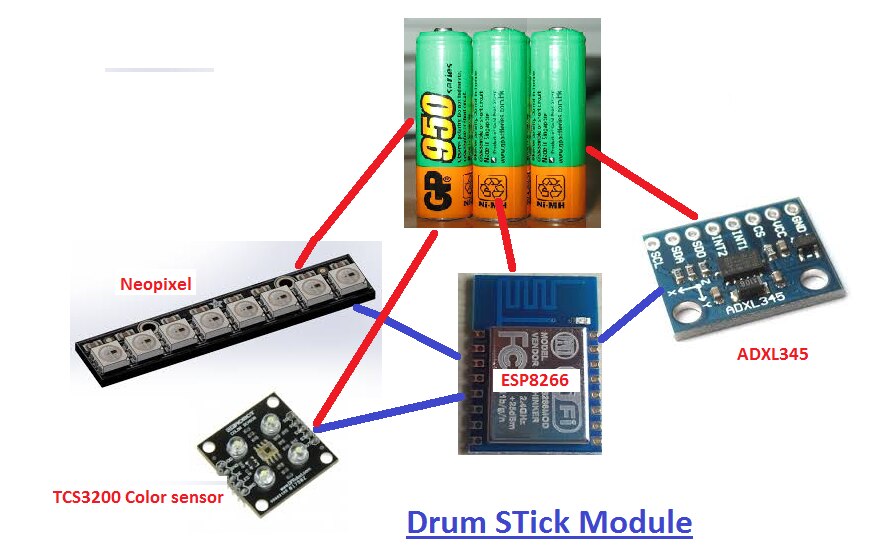

3. Two Identical Drum Stick: This will be ESP8266 based module attached to the 3D printed hollow drum sticks. Accelerometer detects hit on drum and than detected MIDI note will be sent to BBB using UDP via WiFi link. Here TCS3200 Color sensor module will be used to detect color of the surface on which stick got hit to recognize different Toms and Cymbals based on its different surface color. Neo pixel led strip on Drum stick produce lighting effect on stick as per different Toms and Cymbals and velocity of hit.

    Good idea! Using colors so select different sounds sounds like a good idea, hopefully those Neopixels on the stick will not affect the performance You should also take into the account the fact that drummers…

    I have taken long time for thinking just to make sure plan of similar issue you have pointed... I have plan but yet to see how it works on my project..

    Midi on BBB with cheap usb sound card (<2$) is tested and works fine... UDP based midi bridge on BBB tasted for wireless connectivity... Serial based midi bridge also tested on BBB... Color sensor tested at high speed... Now just a metter of write step by step instructions and put all together in view of my project...just like fvan did in his blogs ... I have taken long time for my first blog because I want to put clear picture of my project initially and just stick with this in next blogs...

    I am using esp12 since few months and have not noticed any critical delay .. And if such delay creates any issue than I always have back up of my trust worthy CC3200mod... I am only using esp8266 to limit the cost...
