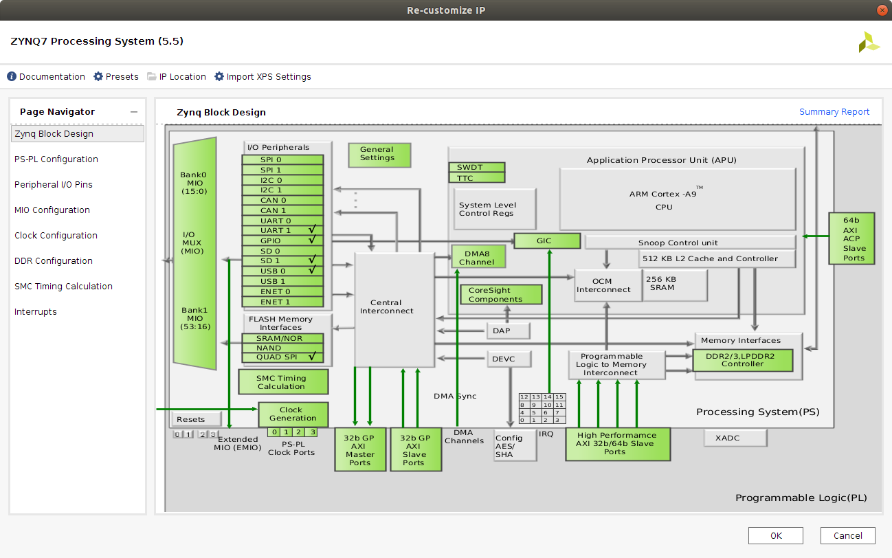

Notice in the above diagram, there are checks next to UART 1, GPIO, SD 1, USB 0,  and QUAD SPI. One of the important lessons they wanted us to learn in this lab was why the order in which you map peripherals matters.
The devices are listed in priority in the green boxes above, with the memory devices having the highest priority,  followed by ENET, USB,... SPI. Another important thing is the flexibility, so while the ENET devices have a higher priority
than the USB devices, you should map the USB first because it cannot be operated via EMIO (Extended MIO). After configuring the USB, we then configured the remaining peripherals and clocks.

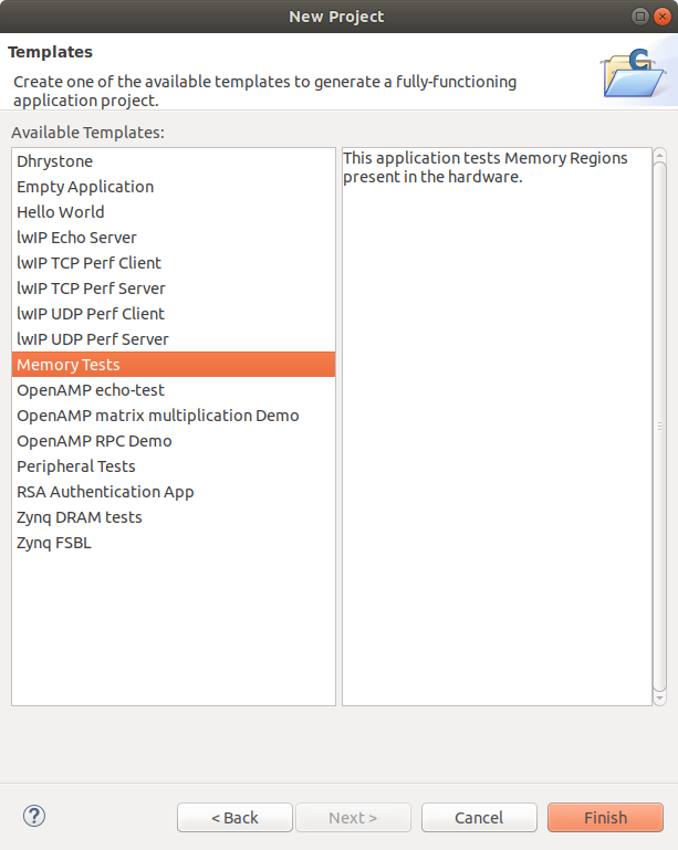

There are templates for a few things, like the Hello World we did in the last lab, but this time they introduced us to a couple of new templates.

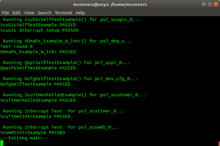

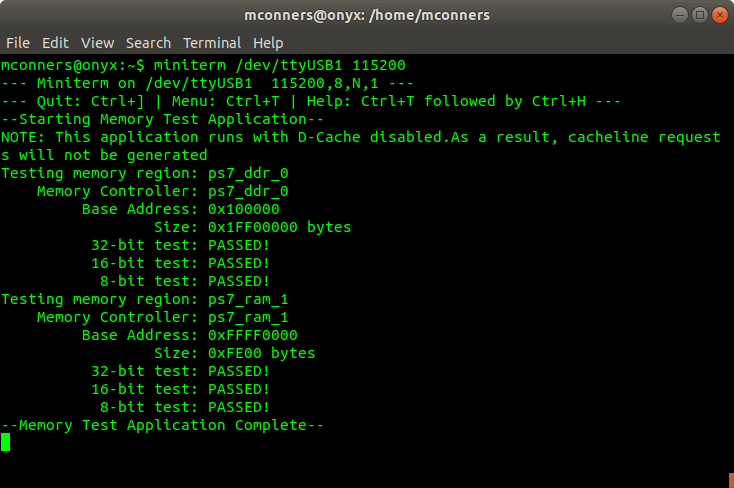

This time they had us select the Memory Tests template, as well as the Peripheral Tests template. The outputs follow:
Those are the outputs of the unmodified templates. Just some quick diagnostics. The source for those is available in the project folders that are created, so if you're curious you can see how they access the devices.
