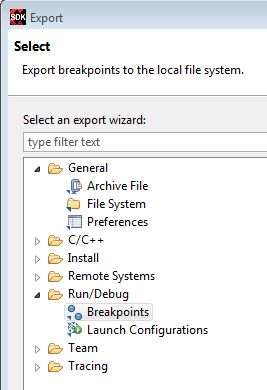

Lab 8 - Archiving
This is all about the process of using source control with the SDK package. It is advised to never just simply zip the Windows folder and send that out as it likely will have a lot of problems. Each user's workplace preferences are unique.
For archiving the source files, this is pretty easy - File --> Export
"Archive file" under General is chosen. We then chose all the items to inlcude in the archive. As can be seen in the screenshot below, we picked everything. This will include all SW applications, FSBL, and Board Support Packages.
I got an error during the export as shown below; but the lab mentions that we may need to go back and do a "Refresh" before we export.
That did the trick for me - I was able to export after doing a refresh. It seems that a refresh does a build of the project; and for some reason redoing the build seems to make SDK happier.
We then follow through and export our Launch Configs and our Breakpoints as unique exports using almost the same methods as before.
I was curious about the files, so I took a peek. The breakpoint file is just an XML which spells out the filename and line number (and a bunch of other info) for each breakpoint.

The "run Configs" file was very similar.
They note here that to export our workspace preferences do still require manually backing up the windows folder; so we go to the subfolder and copy-paste the preference files into a new Backups folder.
That completes the archiving process! Most was very easy as there is a wizard which guides you through it.

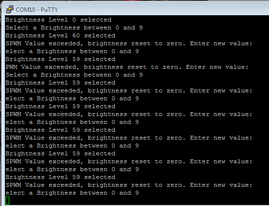

Lab 9 - Interrupts
Interrupts are a good way to catch things which happen quickly without impacting too much main code - for hardware this could be for things like an encoder input or button press. We don't want to have to continually scan buttons for transitions and would rather just use an interrupt. This essentially works like a hardware input which; when asserted; has a dedicated function of code to deal with the input. For something like a button; the interrupt would fire code to say "something happened" and the Interrupt Service Routine (ISR) code block will execute. Typically, ISRs should be written to be 'short and sweet'. This is because they are essentially 'blocking' code and we need to get the processor back to the original task. When the interrupt fires, the processor has to stack up all its current tasks, handle the interrupt, then un-stack everything and keep going. Xilinx even mentions that they have different types of interrupts which can do things like enhance power saving if they are waiting on a resource like memory. That means that one should never use a 'delay' in an ISR; and we would typically just update a variable then exit the ISR and let the regular program take back over.
In this example. we re-open the PWM lesson from earlier; but the 'non-interrupted' version. In this, we let the hardware side handle invalid input to PWM brightness levels. The software code is then updated to include interrupt handling. The interrupt itself still comes from the PL side; but the software does the code execution when this occurs.
There wasn't too much else to this lesson other than that. I did notice (again) that there is a bug in this example code - see the screenshot below.
The word 'select' has the letter 's' dropped every time an interrupt occurs. My guess is this has to do with timing as the processor comes out of the interrupt routine; but I'm not sure.
I should be finishing up the last two labs tomorrow and starting on my project! Parts won't be here for a few more days, but I think I'll be OK.

    aspork42 over 7 years ago in reply to DAB
    That's exactly it - I put an underscore ahead of the word "select" and it gets dropped off.
    I wonder if Avnet / Xilinx has a response for this?
    DAB over 7 years ago
    Nice update.
    I wonder if the output is looking for a control character first, which would explain the drop of the s. Have you tried putting a space at the front of the text?
