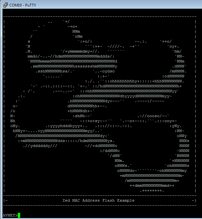

We program the FPGA then launch the new app which we have imported from the sample code. PuTTY gives us a nice ASCII image to look at when the program runs:

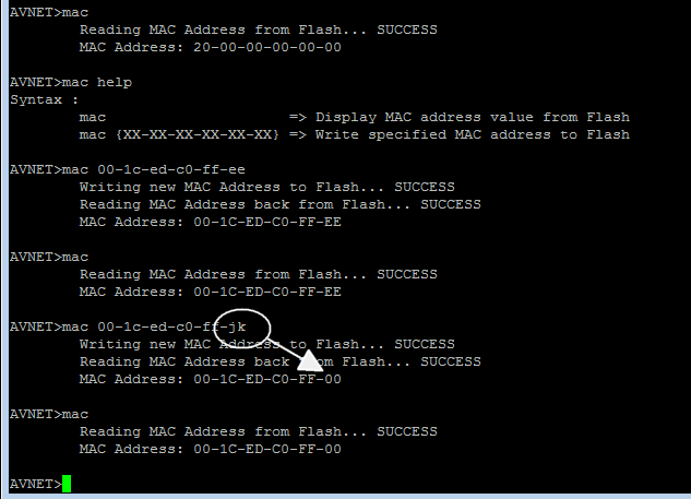

We were then able to read and write the MAC address on the board using this command line interface. Interestingly, the text input is not exactly filtering and sets invalid octects to 00 and doesn't say anything. But as a demo program, this is fine.
That's it for Lab 10 - we have used a library in our project and can use it to read and write to Flash (non-volatile) memory!

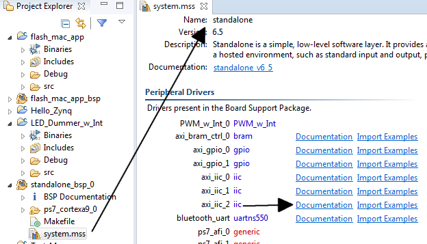

For starting, we are again reminded that we can view the .mss file of the board support package to reach the implemented libraries and their documentation.

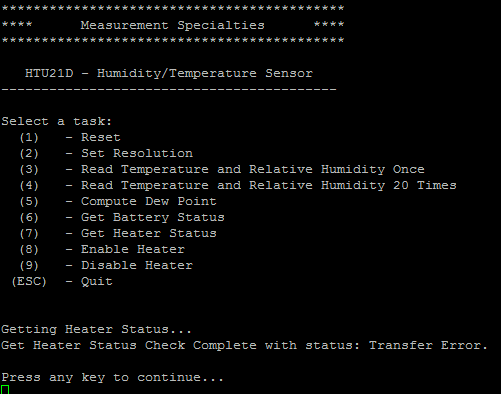

We program the bitstream to the MiniZed, then launch the program. From the console window (PuTTY), we can see a new interface with prompts for each of the functions in this demo program. Since I don't have the actual PMOD sensor, I get appropriate "Transfer Error" messages for every request.
That concludes the test lessons! I'm reviewing the code for Lab 11 as noted since it applies directly to my project for this training.
