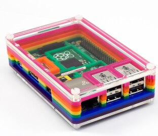

Meet the Raspberry Pi B+ - in a nutshell, it is basically pure awesome.
It has more GPIO, double the USB ports of a standard model B, a better layout of connectors on the board, what more could you possibly want?
