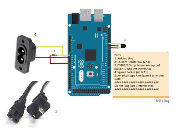

This Blog will Cover How to build a cheap EC meter for your aquaponics/Hydroponics or water quality related projects. We are not going to get into what the ideal value of PPM or EC is, Just cover how to measure and quantify a fluid.
Parts:
-MCU of your choice with ADC
-DS18B20 waterproof temperature sensor
-500 ohm  [or 1kohm resistor]
-Type A Two Prong american plug to Figure 8
-Female Socket for Figure 8 connector
So why are we using a plug:
-Cheap
-Available worldwide
-Standard size [makes calibration easy]
Use the solid prong one like below and not the one with holes:
Wiring it up:
Note: You want the Solid Prong type plug
Do not Plug the pronged plug into the mains

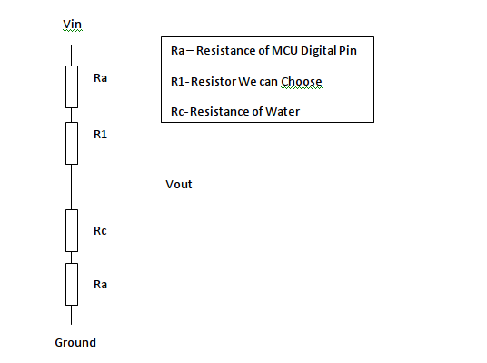

Deciding on Value of R1
//-----------  Do not Replace R1 with a resistor lower than 300 ohms    ------------
We can change the Value of R1 in the voltage divider to change the range of EC we want to measure. Below is the Equivalent Voltage divider circuit.
Ra
Ra the resistance of the digital pins is not stated in the data sheet instead we need to pull it out from a graph.
Going off the graph on page [387] of the atmel 2560 Data Sheet “Figure 32-25. I/O Pin Output Voltage vs. Source Current (VCC = 5V)”
V=IR
Ra= V/I [From Figure] V=0.4 I=1.5e-4  R=25 ohms estimated
Rc
Rc will change with EC [PPM] of the measured fluid. we will calculate the maximum and minimum values we expect to see for the range of fluids we wish to measure taking into account temperature changes and the cell constant K. [We will estimate K to be 3 for the plug probe, estimate from previous tests]
EC  =  EC25*( 1 + a (T - 25))
R=(1000/(EC*K)) +Ra
Min temp=0 [we arnt going to care about EC if the pond is frozen]
Max Temp = 40 *C [I doubt a pond should be above this]
Minimum EC 25=0.3        EC= 0.3*(1+0.019*(0-25)            Min EC= 0.16  S/sm
Maximum EC 25= 3          EC=  0.3*(1+0.019*(40-25)            Max EC = 3.9 S/cm
Min Resistance = 1000/(MaxEC*K)+25 = 1000(3.9*2.88)  =114 ohms
Max Resitance = 1000/(MinEC*K)+25 = 1000/(0.16*2.88) = 2195 ohms

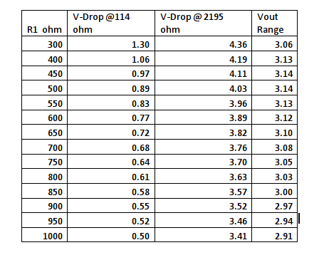

R1
Now we have enough information to calculate a good value for R1 to get the best resolution over our intended measuring range. We could sum it all up mathematically and differentiate to find the peak, but that hurts my head so I just did a quick excel spreadsheet for the Voltage divider for the EC I expect to see:
As we can see we get the largest difference using a value for R1 of 500 ohm, I only had 1Kohm to hand so I will have to live with a little less range.
So we chose a 500 ohm resistor
EC – Range /Voltage Range * (5/ADC steps)
(3.9-0.16)/3.14 * 5/1024 = 5.8e-3 resolution so that is a resolution of 0.0058
To put this is PPM [Tranchen   [Australia] PPMconversion:  0.7] this is a resolution of 4ppm.
Much more than we need for aquaponics or hydroponics.

    Parts:
    -Arduino - Uno/Mega
    -Standard American two prong plug
    -1 kohm resistor
    -DS18B20 Waterproof Temperature Sensor
    Limitations:
    See www.MichaelRatcliffe.com/Projects for a Pinout and user guide or consult the Zip you got this code from

//***************** Converts to EC **************************//
Vdrop= (Vin*raw)/1024.0;
Rc=(Vdrop*R1)/(Vin-Vdrop);
Rc=Rc-Ra; //acounting for Digital Pin Resitance
EC = 1000/(Rc*K);
