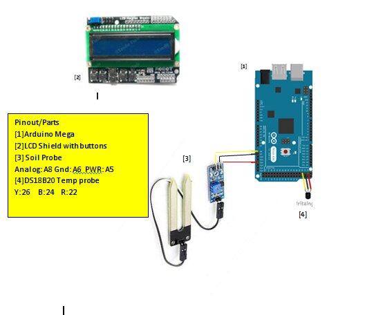

The main problem with the probes in the soil is the degradation from electrolysis of the probe material, you can either buy a capacitive probe or a gold plated resistive probe but maybe we can use a few tricks in the software to prolong the probe life?
We dont need thousands of readings from the moisture sensor, one reading every 5 minutes will probably suffice for most applications. So lets only power the sensor up for those readings.
This Code is suited for long term measurements, use the previous code if you want a portable device that gives instant readings.
The pinout:
[note mistake on pinout for probe, Should be Analog:A8 Ground:A9  Power A12]
This is the code I will be using to compare degradation, in this code we take a reading every 5 minutes and only power the probe for the measuring time, this could improve probe life greatly.
Calibrate the probe using the last blog:
Blog:17 - Automated Soil Moisture Measurement
The Script
we are using a modified onewire and dallas library, [can be downloaded from www.michaelratcliffe.com] if your temperature does not read well, use a 10K pull up on temp data line.
Take the calibration values you got from the last blog and use them in this script
This script will only take one reading every 5 minutes, or when you press the right button on the LCd shield.

    Parts:
    -Arduino - Uno/Mega
    -5v Relay
    -Water Solenoid
    -Soil moisture probe [Capacitive or resitive, doesnt matter]
    -LCD shield with buttons [DFRobot is pretty cheap]
    See www.MichaelRatcliffe.com/Projects for a Pinout and user guide or consult the Zip you got this code from
    or Search Element14 for Adapted_Greenhouse home page [lots of info here]
