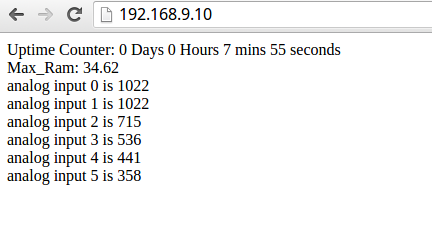

For People running a headless set-up like myself it can be very useful to turn the arduino and ethernet shield into a basic web server.
This is a very basic blog heavily based on the work of other people [see the top of the code for credits]
What you will need:
>Arduino [uno or mega]
>Ethernet Shield
>A router near your grow
The last one might be a problem for a lot of you, I've got a router in the greenhouse repeating the Wifi around the farm Hopefully you will have something close by. [if not , consider a ESP8266 these deserve a whole blog series of their own, epic little MCU's ]
Code
The code will turn your ethernet shield into a webserver, simply type in your arduino's IP address into your browser when on the local network. Ive added the two things any code should not be without, a RAM watchdog [you will not regret this as your project grows] and a basic uptime counter, both of these help with debugging your operation.
Once the code is uploaded you should be able to see your data by browsing to your arduino's IP adress in a browser when on your local network [you may have to give it a static IP in your router]
The Ip for this code is : http://192.168.9.10/    [Yours wil almost certianly not be the same subnet, more likley 192.168.1.X]

Printout:
Everything is working as we expected, here is a printout I got from chrome.
In a following Blog we will be trying to achieve a few things simultaneously  with this Ethernet shield, on-line data logging to the cloud, a local webserver and a SD logger. I dont quite have this figured out yet, but I hope to find time to work on it soon.
