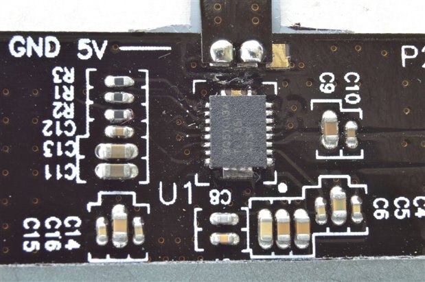

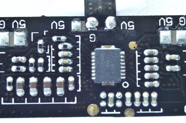

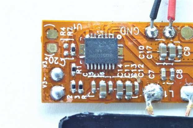

In my last post I was using was using off the shelf Wireless Charging Receivers.
While these aren't using Wurth's coils (sorry Simon), they are using TI's BQ51013A or B chips.
This one is hard to see as the sticky label/cover has removed part of the colouring on the IC.
As you can tell they simply change the tail to suit either a wired or Micro USB
The nice bit about both of these is the various options for where to take the 5v from. In some applications it may be more suitable to use the side.
Adafruit version.
Interestingly in all three of these units, the business end is on a film style PCB, and as far as I can see isn't 4 layers.
It's definitely flexible, unlike the ferrite material which has masses of cracks.

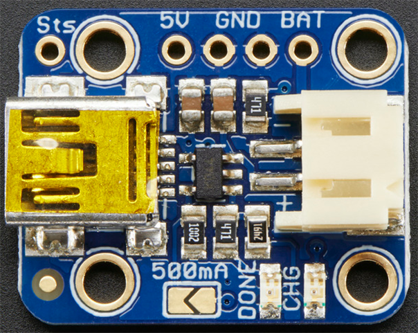

and a suitable charger
https://www.adafruit.com/product/1905
The charger is default at 100mA, but you solder a jumper and it gives you 500mA
The charger includes two LEDs which show red when charging and green when completed.
I'm currently reconfiguring my layout to make these visible through the opaque disc.

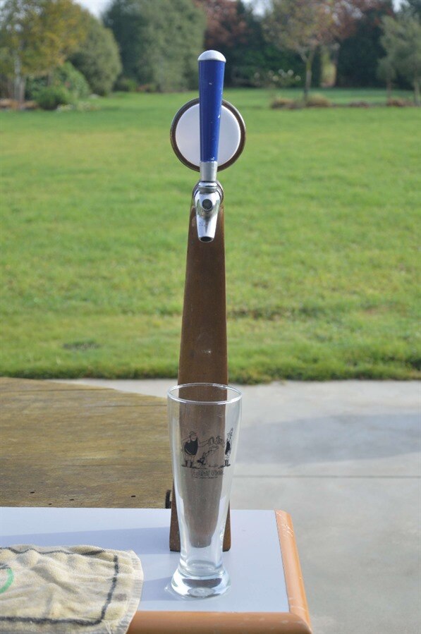

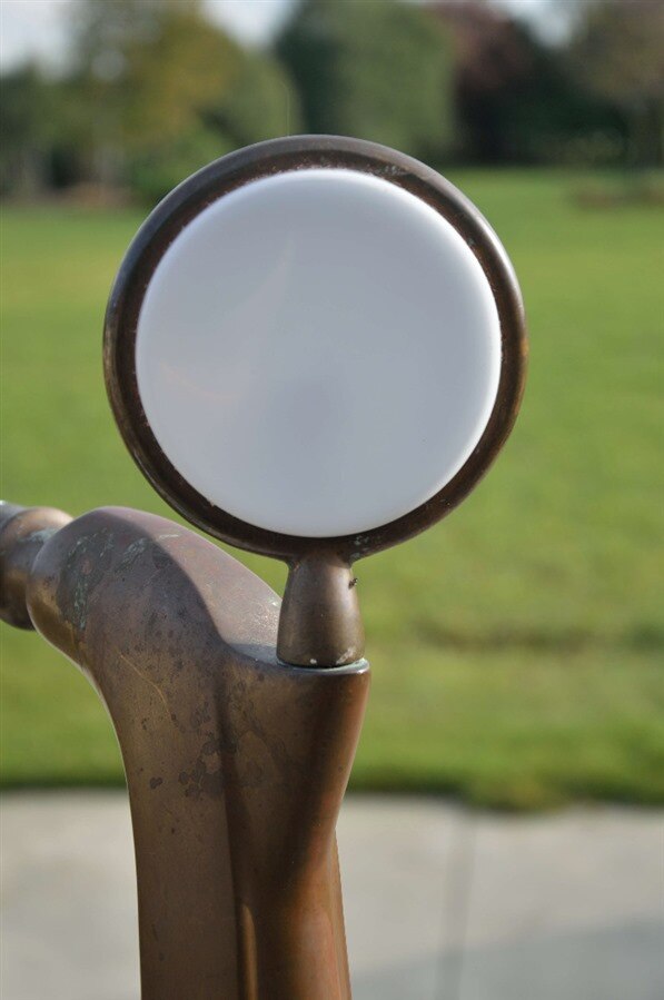

The Item
In the previous post I had eluded to this mystery device, that you couldn't just buy.
Part of that mystery was trying to photograph it, since I needed daylight and some room.
Luckily today worked out fine and dry, and after a quick mounting onto a suitable fixture.

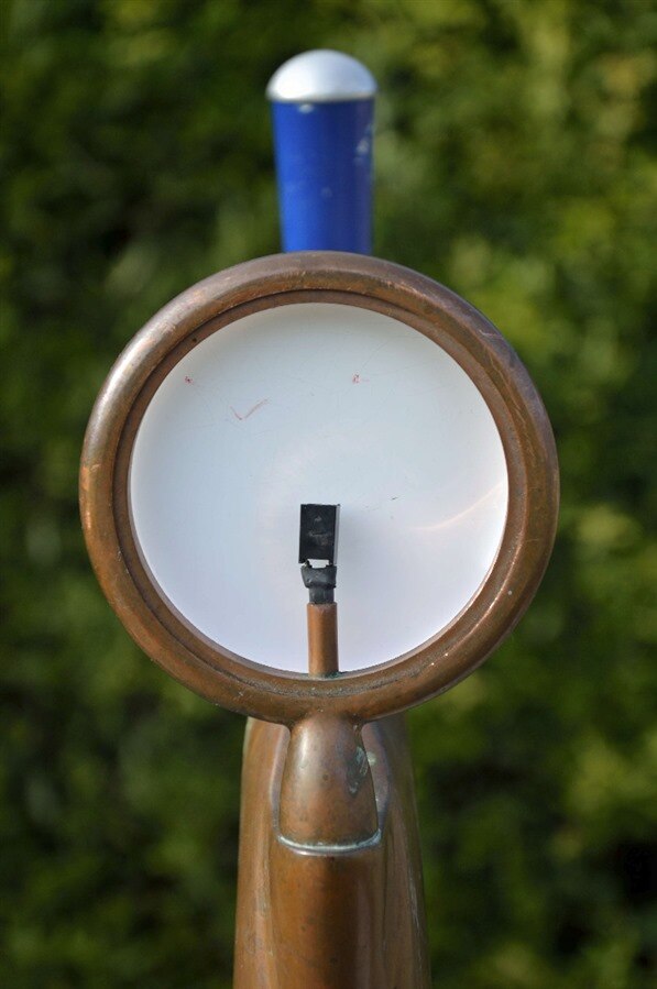

It's an illuminated Beer Tap.
Normally these have a small lamp inside the disc.
Two wires run down the neck and they are powered.
The opaque discs are larger than the ring and need to be persuaded into it. I was lucky they hadn't become fragile, but I imagine they would.
Getting the discs out is not a 5 min job, so replacing the lamp can't be a favorite job
In NZ we like our beer cold, and the better bars even chill the glasses ..they don't like you when you hand it back due to the glass being hot from coming out the sterilizer.
The Tap contains a refrigerant pipe loop and in most bars the entire neck is frozen, this ensures the beer is cold when it hits the glass.
This would not help when you wanted to swap lamps.

    Thanks for discovering Kobo and Adafruit RX boards Qi receiver boards and making high resolution photos allowing to see their PCB layout in detail. Would be nice to have photos of the backside too.
