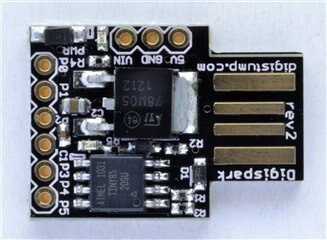

These need a controller, and since its only a single wire, then an ATtiny85 will work fine.
I have a few Digisparks http://digistump.com/products/1 (and some new DigiSpark Pro versions on order).
As you can see the regulator is bigger than the Attiny85, and once its programmed I don't need the USB and other components.

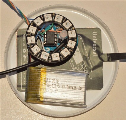

Mockup
I'm not quite ready to show the final product this illuminates, but its already drawn some attention as I carried it through the office at work.
This is the mockup of the parts to be used sitting on the opaque disc.
minus the USB to LiPo charger which somehow wasn't in the photo
For safety reasons I will be swapping the LiPo shown here.
This was obtained for a RC application and the 20C at the end indicates it has no protection mechanism.
Adafruit have provided a very good article that helps de-mystify the LiPo minefield.
https://learn.adafruit.com/li-ion-and-lipoly-batteries/overview
So if you want to avoid this
Use a LiPo with protection, or stick with a LiON from a cell phone which has a rigid case and inbuilt protection device.
