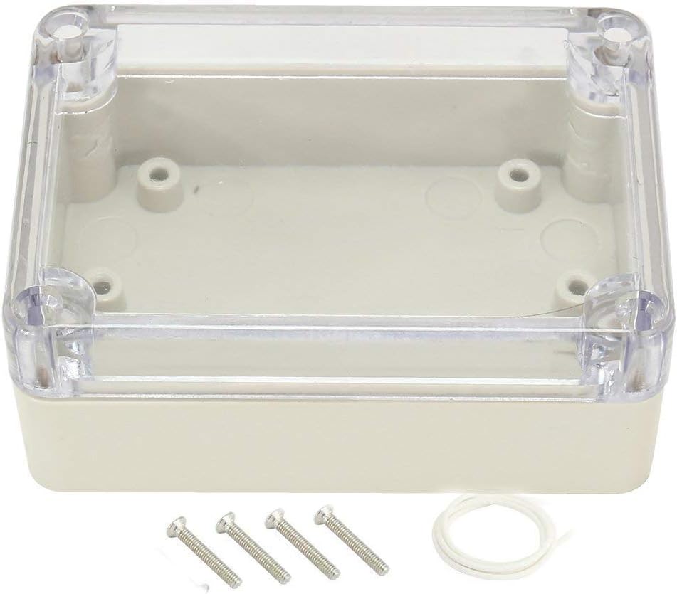

    craigst potting SUCKS we used it in the military :{
    why not just get a small waterproof box with a latching lid, I have on for my ultrasonic parking detection thing just under my front bumper. No-Fuss, No-Muss!
    imageThey come in all sizes and sometimes you score them at tradeshows (free) they hold biz cards. (low)

    I would but its the beacon unit its self no much room as 2 inchs thick im going to try seal it from water but want to see if there's a liquid spray or paste I can add to stop water shorting it out

    ok, what are the dimensions?? Small boxes are cheap!
