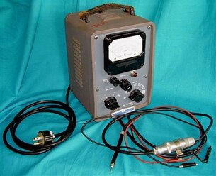

    Michael, Identifying unknown transformers is a black hole. Sometimes like the other day, I found this neet, really heavy, over 5 lbs, transformer in a stereo. My mind said, "keep it". First I tried just to google the part number. No Love.  So I looked up the stereo's service manual, which gave me connections, and voltages. So. Nothing is really unknown, you just have to know where to look. And BTW Google is your friend, NEVER toss out old Databooks, and in your travels, if you see one you don't happen to have, BUY it you will never know when you will need it. You can try a website PartStat, it is not that good for your older parts. In the last two moves, I have lost upwards of 50 databooks, not including, My prized set of HP catalogs (hardback) from 1958 through 1990.image

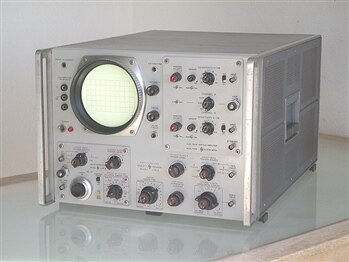

    Early on I had two pieces of HP gear a VTVM 410B and a 175A Osciliscope 50Mhz Hybrid (both Semiconductors and Tubes)

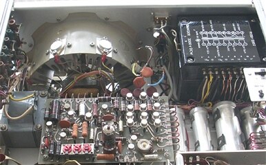

    When I bought the scope had been a repaired the focuses control now working backward. Please note the fan housing with the power transistor around it. As I later found out they were germanium ie fastest fuse in the world.  image But what you don't see is the power terminal strip just out of the picture by the tube. I'm testing the beast, with the 410 and the RF probe with its nice shiny aluminum cover came swinging down and you guessed it right on the power strip. After many hours (days) of repair, I got the scope working again. If I remember correctly I had to go into the 410 and unsolder the RF test lead. Later I got myself a Fluke and never looked back. imageimageimage
