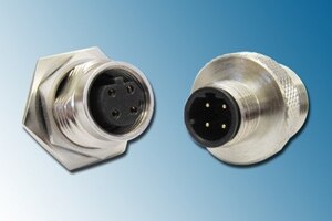

AmphenolRegistered Industrial Max-M12 Series, Datalink Connectors
In the past, high speed data transmission lines have been installed into industrial applications with little regard to high vibration, high temperature or harsh environments. But as more heavy equipment, rail transit, and process control systems utilize high speed datalinks, the need for a ruggedized connection system has increased. The AmphenolRegistered Industrial Max-M12 Series data communication connector is built to withstand harsh environments and electrical noise. Based on IEC 61076-2-101 and SAE J 2839 standards, the Max-M12 Series can withstand connector-to-cable retention forces of 444 newtons (N) and contact retention forces of 110 N (tested at 100 mating cycles minimum). All versions of this high speed connector are IP67 or above, making them dust and waterproof, and resistant to high pressure and high temperature washdowns. It's rated for 60-250 VAC/DC, depending on the model, and 4A.
