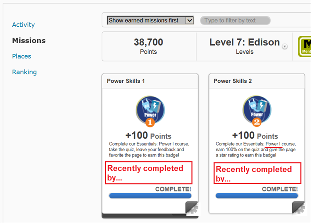

Power Skills 2
Power Skills 2
Complete our Essentials: Power 2 course, earn 100% on the quiz and give the page a star rating...
Are you ready to demonstrate your Power Essentials Energy Harvesting Electronics knowledge? Then take a quick 15 question multiple choice quiz to see how much you've learned from this Essentials of Power 2 Module.
To earn the Power Essentials 2 Badge, read through the module to learn all about Energy Harvesting Electronics, attain 100% in the quiz.

    DAB over 8 years ago +3
    Nice update, but you are missing a letter. In the text you have Admium Telluride instead of Cadmium Telluride. DAB

  • beacon_dave
    beacon_dave over 8 years ago in reply to rscasny
    Hi Randall - under the user's 'Reputations and Points' page e.g. at:
    https://www.element14.com/community/reputation.jspa?username=beacon_dave&viewID=missions
    Power Skills 2 mission refers to 'Power 1 course' and the icons for the 'Recently completed by' don't show:
    and clicking on the 'cog' reveals a mention to the 'Power I course' again:
