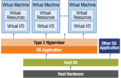

diagram 7
Figure 7: Hypervisors
Using a hypervisor enables the developer to allocate resources and enable access to system resources only as required. This provides for increased robustness and security in the end-application.
There are two types of hypervisors. Type-one hypervisors are configured by hardware and there is no software between the processors and hypervisor, while type-two hypervisors are run on a host operating system. One example of a type-one hypervisor is Xen, while an example of a type-two is Virtual Box. Both are commonly used in the development of programmable SoCs, with Xen being used on the programmable SoC itself and Virtual Box being used by developers to create Linux images depending upon their development environment.
diagram 8a diagram 8b
Figure 8: Comparison of the application of Type-One and Type-Two Hypervisors
