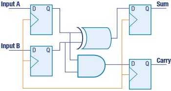

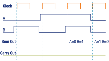

Combinatorial logic circuits are unable to implement functions that require knowledge of their previous inputs or decisions as they contain no memory/storage elements.
In contrast, sequential circuits' outputs are based upon not only current inputs but also previous inputs and decisions. Sequential logic circuits achieve this by using storage elements called flip flops, the simplest of which is the D Type flip flop. The value stored in the flip flop is updated at a regular interval as indicated by the clock signal.
diagram 18
Inputs Outputs

- 9.1 Half Adder in a Synchronous Design
In this example, you can see the two-clock cycle delay between the application of an input and the generation of the output. The first clock cycle stores the inputs A and B in the first flip flops. The output of these flip flops will then be passed through the combinatorial logic, in this case, the half adder. The output of the half adder is then stored into the second rank of flip flops and output on the second clock cycle.
diagram 19a
Figure 19a: Example Half Adder in a synchronous design (clock is shown in orange).
diagram 19b
Figure 19b: Timing Diagram for the example Half Adder in a synchronous design above.
