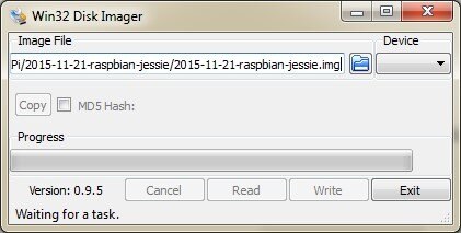

Operating System A more up to date operating system is needed for the RPi-0.  Raspbian-Jessie or later is recommended.
You can get the image here: Download Rasbian-Jessie Image You can then use a program (like Win32 Disk Imager) to write the image to an SD card.
The image is a little more than 1Gb while zipped and a little over 3Gb when unzipped.  You will need some space on a local machine when you are working with it.

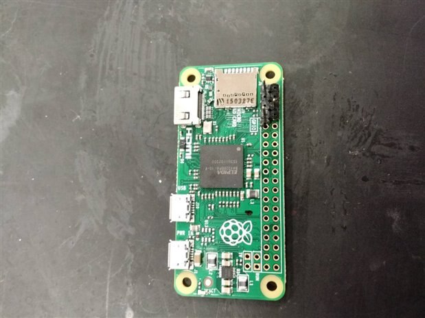

Booting Up Once the operating system is loaded up, you can plug it into the RPi-0.  It doesn't click in like the RPi-2 (you have to get to $5 somehow).  Plug in power, and look for an intermittently blinking green light to see that all is working (the red LED is also gone). Attach pins to the GPIO Another thing that had to go was the pins on the GPIO.  The RPi-0 can still interact with the real world, you will just need to attach some pins.  I did this with a new Holiday Bundle from Circuit Specialists (video below).

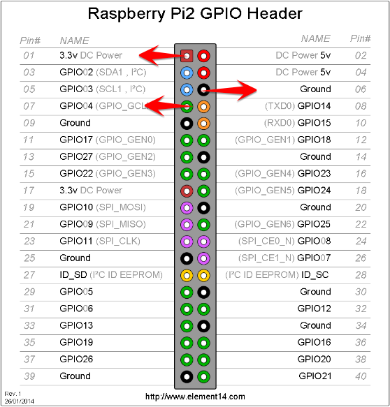

I used the soldering kit to attach 4 header pins to the top of the Raspberry Pi.  You can see the attached pins on the top right of the RPi-0 here.  I used regular headers, and just pulled the ones I didn't need out with a pair of pliers.  I found that this was easier than just making the single connections I needed. We will need three connections.
  • Power - 3.3v
  • Data - GPIO 4
  • Ground
The GPIO layout is the same as the 40 pin layout for the other Raspberry Pi models.  The connections that are needed are labeled here with arrows.

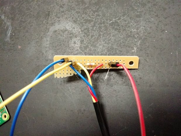

Again I found it easier to attach four headers and just pull out the ones I didn't need before soldering. Make the Circuit To set up the temperature sensing circuit you will need:
  • A waterproof DS18B20 Temperature Probe
  • A 4.7k Ohm Resistor (sold with the probe)
  • Protoboard
  • Solder
  • Male to female jumper wires (I used 6)

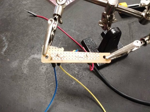

There is a 4.7k resistor between data and power.  This tutorial from Adafruit is wonderful for setting things up.  Also, you can do this with a solderless breadboard.  I wanted something a little more robust, and went with soldered connections. When it is soldered together, it should look like this:
The female ends can be attached to the pins on the Raspberry Pi.  The connections are:
  • Probe Red - 3.3V
  • Probe Yellow - GPIO4
  • Probe Blue - Ground
