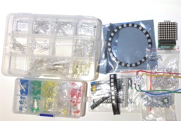

● A selection of LED’s A selection of LED’s A selection of LED’s - A kit of through-hole LED’s will not only make your projects look cool but they can be extremely useful diagnostic tools as well. Wiring some LED’s to a couple pins on your microcontroller project can be programmed to give a wealth of information based on blink rate, intensity etc. etc.

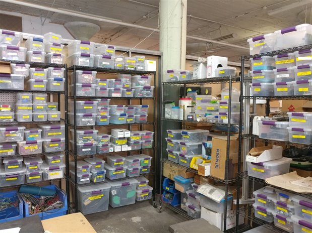

    In a reply to John's suggestion about having a supply of switches and other parts around -- I didn't add that to the list, but I feel that having surplus parts is completely necessary.
    The picture below is a portion of the parts stored at my shop. A large collection of parts is a nice complement to a well setup workbench.
    • Vote Up +8 Vote Down
  • Catwell
    Catwell over 8 years ago in reply to jw0752

    14rhb over 8 years ago in reply to Catwell
    And labelled up as well - nice one.

    jw0752 over 8 years ago in reply to Catwell
    Hi Cabe,
    OK, you have my attention!  I like it very much and now I want to see the rest.

    three-phase over 8 years ago in reply to Catwell
    Wow, that is an extensive collection to have amassed. Is that from left over parts, parts acquired from second-hand devices or a deliberately stocked collection?
  • Catwell
    Catwell over 8 years ago in reply to three-phase
    It's a mix of old industrial surplus, parts I bought for projects and a few items I scavenged.
    To put some of that into perspective, in the boxes are little devices and parts I've had since grade school.
    I think that's the case with a lot of engineers I know... we hold onto every little electronic scrap we get.

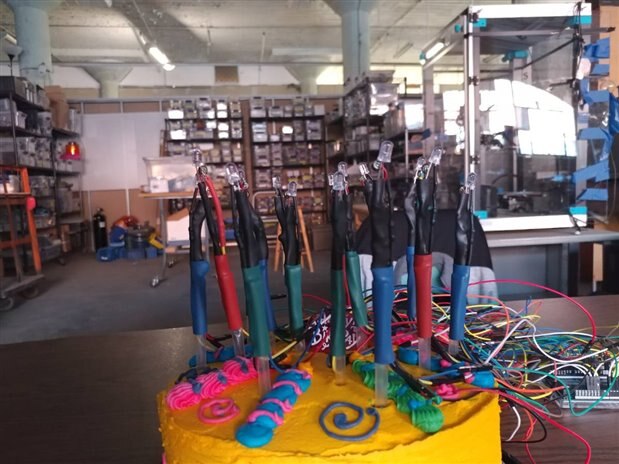

    The below pic is from my Arduino Birthday project here on element14. You can see more of the storage area of my shop.
    Other areas of the shop not shown:  More storage, mechanical components, machine shop, conference area.
