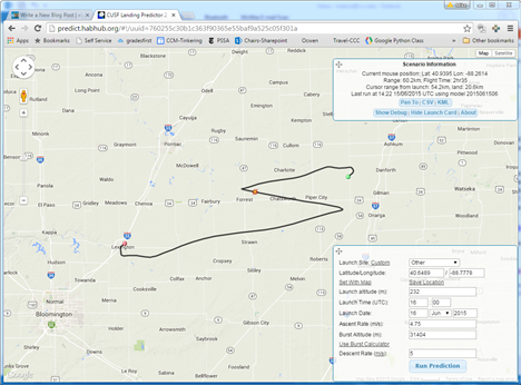

We use the HABHUB site for making predictions about the landing site of our balloons.  It asks us for:
  • Launch site (including latitude and longitude)
  • Launch altitude
  • Launch time (in UTC)
  • Launch date
  • Ascent rate
  • Burst altitude
  • Descent rate
Here I searched on the map for Lexington, IL (a place we commonly launch from) and found its elevation using Google.  The time and date are easy as well.  They are also very useful for trying to determine things a day or two in advance.  Since our vertical flight goes through the jet stream, we can't really count on anything that is more than a couple days away from the actual launch date.  In short, we become more certain about things the closer we get to the launch date and time.
Above you can see the burst calculator for a 2000g gram balloon made by Kaymont.  The target burst altitude or target ascent rate are things that we would try to reach for.  I calculated the ascent rate using another calculator found here.  The result is in feet/min which we convert to meters/sec for this calculator.  As you can imagine, anyone that teaches dimensional analysis or unit conversion would have a field day with this stuff.  There are all kinds of conversions that need to be done.
With this information, we can get a prediction for this flight.
This zig zag motion is pretty common for our flights.  Winds close to the earth and the jet stream will grab the balloon and take it north and east.  Once it emerges from the stream, it will head back west.  After it bursts, and comes back down, it will come east again.  In the end we should expect to collect the balloon close to the I-57 expressway.  When I switch over to Google Maps, I can see that this is in Danforth, IL, and in a farming area.
The landing site is pretty good.  Right now, I have now idea what is growing on the field (soy being short is preferable to corn).  But I can see that it is not near a populated area, its not near a river, and it is more than 5 miles from the expressway.  We wouldn't want to come down in a busy road.  Depending on some other factors we may choose to launch a little further to the west so we are further away from the expressway, but for now this looks good.
