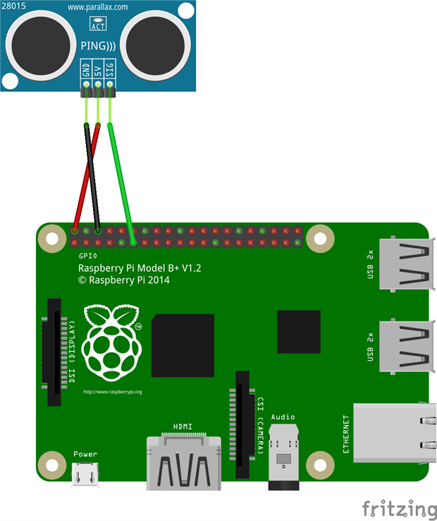

The Ping (as I will refer to it from this point forward) is a very simple device. It requires only 3 wires to connect it to the Pi. One is +5V which can be grabbed directly from pin 2 of the Raspberry Pi, one is Ground, which is provided on pin 4, and the third is pin 11, one of the available GPIO pins. A Fritzing diagram is provided for reference.
That's it!!! That is all that is required to connect this circuit!!!
According to the Ping documentation, it is perfectly safe to connect to a 3.3v device such as the Raspberry Pi. This is something very important to check because providing an input over 3.3v to any of the pins on the Raspberry Pi can cause damage to the device. Also, all electrical connections should be made when the Raspberry Pi is off and there is no power applied. Even a circuit as simple as this can be miswired so double check all connections.

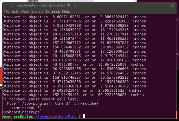

When it executes, you can expect the following output:
You can stop execution of the program by typing ctrl-c (the ctrl key and the c key at the same time), this will send an interrupt to the process and tell it to stop executing. Wave your hand in front of the sensor, pick it up and point it at the monitor, watch the values change.

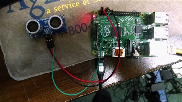

One final picture, the sensor in action:
