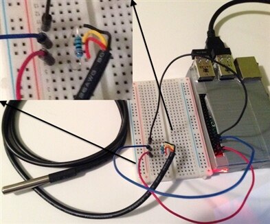

The hardware connections:
- put the 3 leads of the DS18B20 into the breadboard. (I found this worked ok enough, but ideally it's better to solder some good tips onto them for stronger connections.)
- connect a jumper wire from the yellow (data) wire to pin 7 (GPIO4) on the Raspberry Pi
- connect a jumper wire from the red (power) wire to pin 1 (3.3v) on the Raspberry Pi
- connect a jumper wire from the black (ground) wire to pin 9 (GND) on the Raspberry Pi
- add a 10KΩ resistor between data and power
So that's the hard part.
This is what is looks like:
(Check out my duct tape Pi case!)

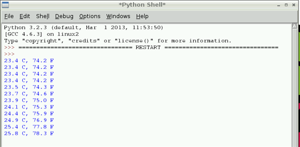

Now open up the attached example (DS18B20.py) and run it, and you should see temperature numbers showing up on the Python console.
If you see error messages, it is most likely due to a loose wire. In my case the DS18B20 leads are a little short and one popped out, which caused some scary looking error messages when I tried to run the script!
The other thing I forgot at first was that 10K resistor - it is vitally important too.
This is what the output should look like, with numbers depending on your temperature, of course. Try putting your fingers on the sensor to see how that affects the readings.
