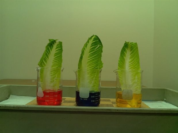

Now you can set up for your actual experiment.  This is actually the hard part.  You want to find something that changes dramatically, but does it very slowly.  Obvious things include clouds, traffic, etc.  I didn't have access to a good view or anything I would consider to be weather-proof.  So I went with lettuce leaves changing their color when placed in a small amount of food coloring.  Here they are at the start of my experiment.
Over time, through capillary action and some other processes, these lettuce leaves should absorb the food coloring in the beakers.  So now I am ready to get it moving.
