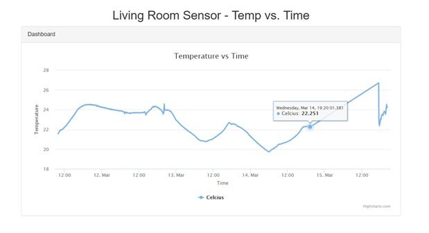

This tutorial will walk you through the process of getting data from the BME280 Temperature, Pressure, and Humidity sensor to be displayed on a local webserver.  We will log the data with a Raspberry Pi, keep it in a MYSQL database, and feed to Highcharts using PHP.  This project is the culmination of a *ton* of work and a *ton* of mistakes that I would like to help you avoid.
In the end, you’ll get a marvelous graph embedded in a webpage like this:

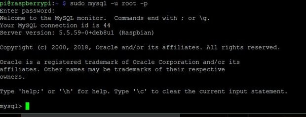

At this point MySQL is installed, you will just need to start it.  In the command line, type:
sudo mysql -u root -p
It will ask you for your password.  Once entered you will get another command line interface.

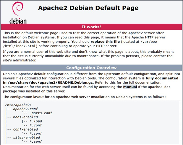

Make a Web Server
Now we will make the Raspberry Pi a webserver so we report the sensor results to a web page.  Luckily, this is really easy.
Use the following command
sudo apt-get install apache2 php5 libapache2-mod-php5
This installs the software that will let your Raspberry Pi serve up a web page.  From the RPi you can go to localhost.com or its IP address to see your default web page (192.168.0.3 was mine.)
The code for this page can be found in your /var/www/html/ folder.  So lets go there and make a new file called index.php.
cd /var/www/html
nano index.php
At some point, you will need to delete the index.html file that is there. If you don’t do that, you won’t end up seeing the .php page that we are making. You can do this now by removing it.
rm index.html

The magic is in the query portion (lines 10-18). Here we set up a while loop. It goes through the bmesensor table, and selects the datetime, and temperature values. Those get put into an array called dateTemp.  I went through several iterations before I finally got this right.  Line 20 has something that is commented out, but useful.  If you uncomment it those [x,y] pairs will be printed so you know you are on the right track.  The json_encode portion removes quotes, making it easier to put things into Highcharts.
The html Section
Living Room Sensor - Temp vs. Time
Dashboard
There is more here than there needs to be.  I ended pulling from a number of sources, and I should probably clean it up a bit.  There are some things to pay attention to in lines 4-8.  These are various script sources that are needed to run Highcharts.  Lines 7 and 8 give the x-axis the right time zone, since our time is measured in milliseconds from the epoch.  Line 22 creates a container for the Highcharts chart.
Highcharts
This is the final section.  It is some code that is used to generate an interactive chart.  This could be its own tutorial/lesson/class/graduate degree.  It is incredibly powerful, and equally challenging for a novice to pick up.  The code I used is below and it goes between lines 13 and 15 in the code above:

<h2 class="text-center">Living Room Sensor - Temp vs. Time</h2>
