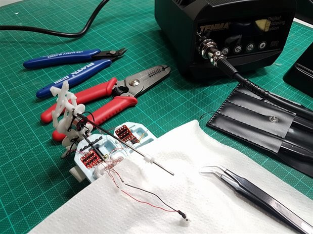

We used a 3-axis CNC Milling Machine to fabricate most of the structural parts of the platform. Power tools and hand tools are also required for mechanical processes such as grinding and cutting of small parts.
The on-board electronics, including the servos, speed controllers, and motors, are some of the smallest in the market. A single cell Lithium Polymer (LiPo) battery is used to power the on-board electronics.
Since our platform is tailless, it is inherently unstable. We chose to integrate Lisa/S Autopilot to actively stabilize the MAV. The Lisa/S Autopilot is the smallest full-fledge autopilot in the World. Hence, we selected it because it is the most compatible autopilot system available in the market for our small platform.
