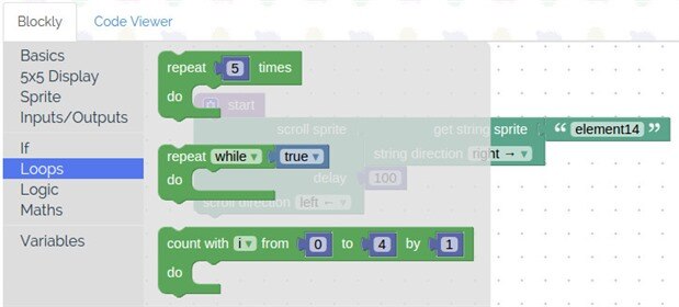

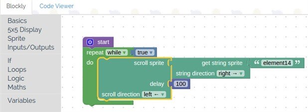

    gregoryfenton over 11 years ago
    This message will only scroll once and then stop, which is not much use as a name badge.
    If you add a loop (click on Loops and drag repeat while true onto the script), and place the scroll sprite part into the gap it will run forever (or until the battery runs out).
    Select repeat while true
    Move everything below start inside the repeat while true block and move the repeat while true block directly under the start block.
    Here is my version on the CodeBug site: http://www.codebug.org.uk/explore/codebug/1040/
