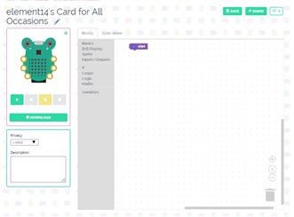

We start the project by visiting the CodeBug website http://www.codebug.co.uk and creating an image
account. It only takes a few minutes. While logged in, clock on Create to start a new project. Don't forget to save your work!
The interface for CodeBug contains an area to the right of the screen with is the primary programming interface. There are a series of menus that are used to store the blocks with can be dragged from the menus into the coding area. Good blocks are made to connect together, and that is what we intend to do!

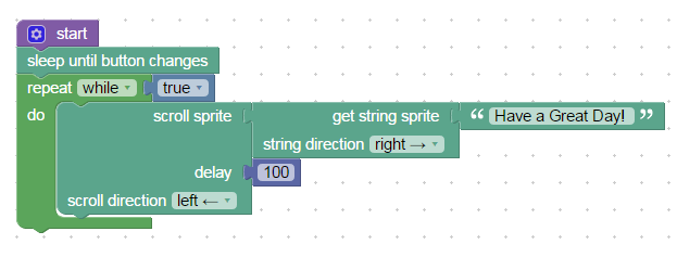

Let's start coding the Display and we begin at...well the start which is a pre-existing block in which the coding is  ready to be built on! The Start block can be used to configure CodeBug when we run the emulation on the interface, for this project we will keep it as is.
For this block of code we are going to select the Scroll Sprite block from the Sprite Menu and connect it to the Start Block. This block will scroll the content to the left of the LED matrix. Since we will need something to scroll, let's also go ahead and use the Get String Sprite, also found on the Sprite Menu, and connect it to the Scroll Sprite block. The default text for the Scroll Sprite block is "Hello World", which we have replaced with "Have a Great Day!". Within the Scroll Sprite block you can change the rate of which the letter will scroll (we have is set at the default 100ms) or the direction of the scroll ( left,right,up, down).
At this point the program will scroll the "Happy Birthday!" message, but only once. For the purposes of this project we will need it to scroll repeatedly. Let's add a Repeat While True block to repeat (loop) the blocks inside it. From the Loops menu drag in the Repeat While True block into an empty area on the Workplace. Next we will drag the Scroll Sprite block into the body of the Repeat While True block so your code will repeat continuously. We'll drag that While Loop and its block onto the Start block.We don't want the CodeBug to start until a button is pressed so from the Basics menu, we'll select Sleep Until Button Changes above the Repeat While True block.
From there you can run an emulator to see how the program would look on the CodeBug...
With the code working, click on Download, it's just under the simulator controls. When the code downloads, plug in a USB to micro USB into your computer. While holding Button A of your CodeBug also insert the micro USB to the CodeBug. The top left LED in the matrix on the CodeBug will flash. Your computer should also recognize the CodeBug as a USB drive on your computer. Copy the code downloaded from the CodeBug website to the USB drive and run the program by pressing Button B.

  • gadget.iom
    gadget.iom over 11 years ago
    It might be worth modifying the code so that it will only repeat X number of times (the number can be substantial). It just means that an accidental press of a button during delivery wouldn't flatten the battery before the recipient gets it. image
