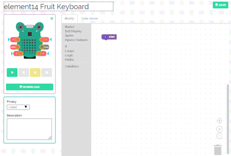

We start the project by visiting the CodeBug website http://www.codebug.co.uk and creating an account. It only takes a few minutes. While logged in, clock on Create to start a new project. Don't forget to save your work!
The interface for CodeBug contains an area to the right of the screen with is the primary programming interface. There are a series of menus that are used to store the blocks with can be dragged from the menus into the coding area. Good blocks are made to connect together, and that is what we intend to do!

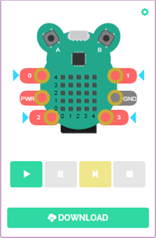

To set the Legs of the CodeBug we will need to first configure the Emulator. To do this we will need to open the emulator configuration via the settings cog on the emulator. Tick the Show Leg Controls box. Click on the Configure Emulator button to complete the settings change. The Emulator will now show the status of the CodeBug's legs with blue arrows. The arrow pointing to the legs is the Input, away from the legs is the Output. When the background of the leg is red, the leg is at Power, when the leg is at black, it is Ground.

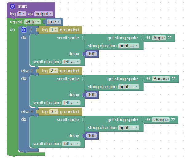

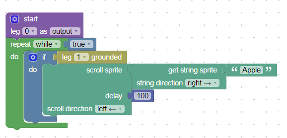

From the If menu, drag in an If block to an empty area of your workspace. From the Inputs/Outputs menu drag a Leg Grounded block and snap it to your If block.Make sure to select from the drop down which leg you will be programming.  From the Sprite menu drag in a Scroll Sprite block and place it inside your If block. Now also from the Sprite menu, drag in a Get String Sprite block and snap it onto your Scroll Sprite block. Change the default "Hello World" to the name of the fruit or vegetiable you will be using in conjunction with the leg ( I used "Apple".  Now from the Loops menu, drag a Repeat While True block and snap it into the Start block. Finally drag the If block into this While loop.
Let's add more fruit the the program. From the If menu drag an If block to an empty space on your workplace. Click on the cog icon on your If block and, in the window that appears, drag an Else If into the If on the right.
Repeat the previous steps for adding in the Get String Sprite and Scrolling Sprite for the other Legs. Select from the drop down of the Leg Grounded block which Leg will correspond with what fruit.

    balearicdynamics over 11 years ago in reply to mcb1
    Me too I have tried to remix the project but the legs won't work. Instead it works fine on the board.
