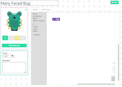

We start the project by visiting the CodeBug website http://www.codebug.co.uk and creating an account. It only takes a few minutes. While logged in, clock on Create to start a new project. Don't forget to save your work!
The interface for CodeBug contains an area to the right of the screen with is the primary programming interface. There are a series of menus that are used to store the blocks with can be dragged from the menus into the coding area. Good blocks are made to connect together, and that is what we intend to do!

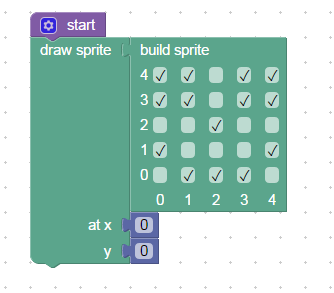

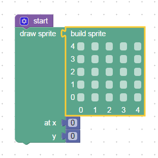

Let's begin at the Start block which is a pre-existing block in which the coding is ready to be built on! The Start block can be used to configure CodeBug when we run the emulation on the interface, for this project we will keep it as is.
For the first block of code we are going to need to use Sprites. Sprites are simple images created by the Build Sprite block and displayed using either the Draw Spite block or the Scroll Sprite block . To display a Sprite we need to drag a Draw Sprite block and a Build Sprite block into the coding area. Join the Build Sprite block into the Draw Sprite block and join that group of code into the Start block.
Click on the different boxes of your Build Sprite block to design your sprite. A ticked box means that LED will be on. Run the code via the blockly emulator and see the "LEDs" light up!

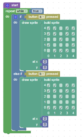

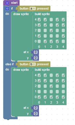

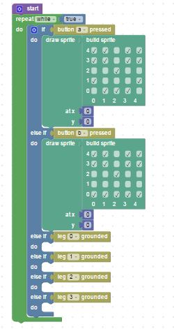

Next we will need to program a different Sprite to be displayed when different buttons and legs are pressed. From the If menu drag an If block to an empty space on your workplace. Click on the cog icon on your If block and, in the window that appears, drag an Else If into the If on the right.
From the Inputs/Outputs menu drag in two Pressed blocks and snap them onto the If block. From the drop down selector tool on the Pressed block we will have the first block as "A" and the second block as "B"
From the Sprite menu drag in another Draw and Build Sprite block and place it inside of the If block.
From the Loops menu, drag a Repeat While True loop and snap it onto your Start block. Drag your If Else If block into this While loop.

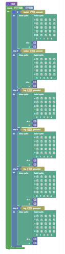

Let's add a few more Sprites into the code. Click on the Cog of the If block and drag four more of the Else If blocks into the If block. Next, from the Inputs/Outputs menu drag in four Leg Grounded block. Join these onto the Else If blocks and number them using the drop down selector tool 0-3.

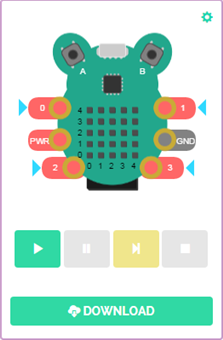

To set the Legs of the CodeBug we will need to first configure the Emulator. To do this we will need to open the emulator configuration via the settings cog on the emulator. Tick the Show Leg Controls box. Click on the Configure Emulator button to complete the settings change. The Emulator will now show the status of the CodeBug's legs with blue arrows. The arrow pointing to the legs is the Input, away from the legs is the Output. When the background of the leg is red, the leg is at Power, when the leg is at black, it is Ground.
Now it's time to add in those extra Sprites. Drag four Draw Sprite blocks and four Build Sprite blocks into the coding area. Join the Build Sprite block into the Draw Sprite block and snap that group of code into the Else If blocks.
From there we can run the emulator with the code...
