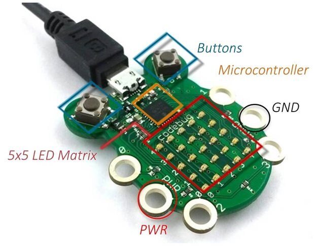

Looking at the board, there really isn't a lot to it. There is a microcontroller, a 5x5 array of red LEDs, a couple of push-buttons, the USB connector and six holes of which two can be used to power the
CodeBug if you don't want to use the USB supply.
On the underside there are a couple more bits of functionality but they are not of interest for the purpose of this blog post.

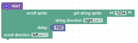

I wrote my first program on the CodeBug. It basically just scrolls the characters '1234' on the 5x5 LED matrix:

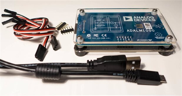

Instead I busted out the ADALM1000 ADALM1000 . It is a cheap USB tool can be used as a mini power source and current measurement device. For this purpose it is like a power supply and oscilloscope all-in-one.
I set it to supply 5V, and connected the two wires to the CodeBug's round holes marked PWR and GND (I didn't plug the USB into the CodeBug).
There is a getting started guide to the ADALM1000 here.

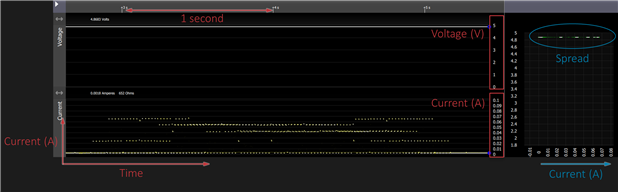

Once it was all hooked up, I saw this output when the '1234' message scrolled by. Click on it to examine it closer:
The top half of it just shows that the voltage was set to a fixed 5V supply (the ADALM1000 can also do fancy stuff like sine-waves, but I just wanted a fixed 5V supply to the CodeBug).

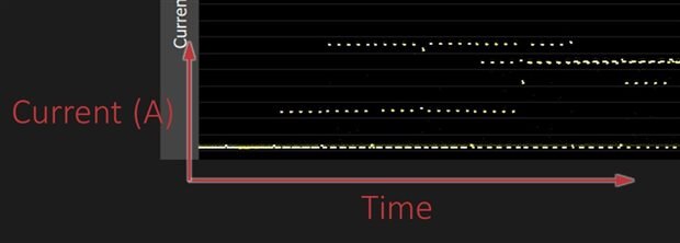

The bottom half shows time on the x-axis, and the yellow dashed stuff is the current consumption over time. It is dashed because the 5x5 LED array is multiplexed and it flashes rapidly (multiple times a second).
(Zoomed in):
It can be seen that the current peaked close to 0.07A (which is 70mA) while scrolling the '1234' message. It can also be seen that the entire message took just over two seconds to scroll.
On the right side of the diagram, circled in blue, is the same information represented in a different way. Here the x-axis is current. It can be seen by the bright parts of the spread line the amount of current consumed for the most amount of time.
The fainter parts of the spread show the current consumed for the least amounts of time. It is like an aggregated view.
