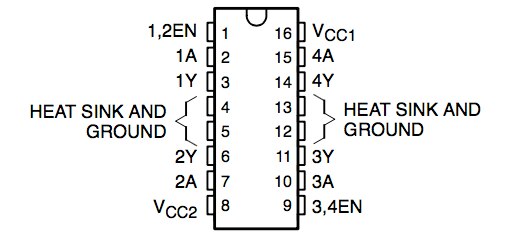

The producer data sheets as we are used to see are not very helpful for newbies. Every components needs a easier document as well as a clear circuitry explanation of the connections.

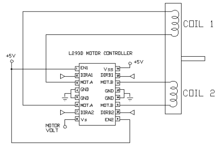

The image above shows the pinout of the L293D and should be accomplished by a clear explanation of their meaning. The document should have different levels of reading, depending on the interested of the audience to go more or less in depth to understand the sections.

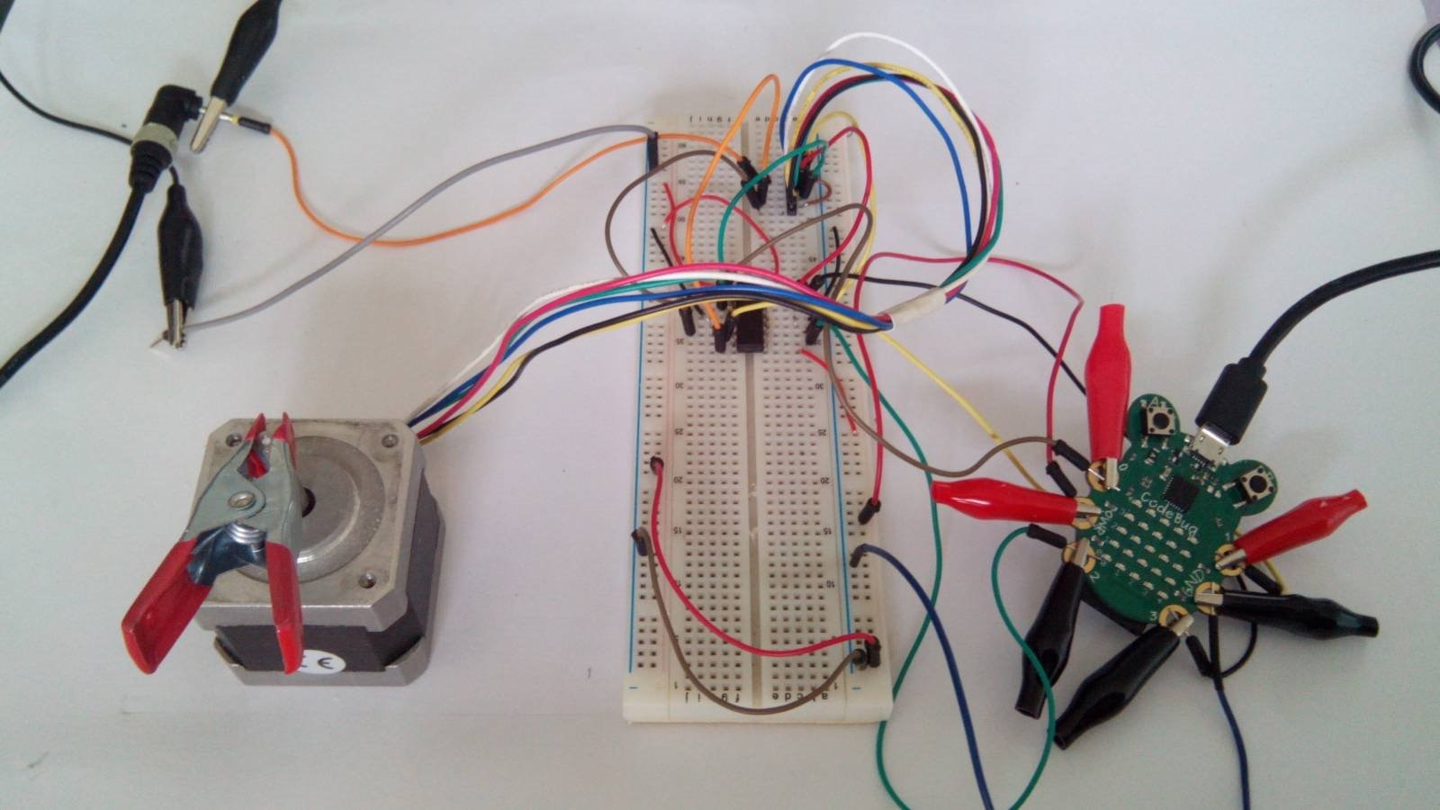

With four output pins (that are also the sensing buttons and more depending on what we configure) the answer is yes. What is shown in this post is the proof of concept, I mean something really working based on the use of the only two components mentioned above: a 5V, 6 wires unipolar stepper motor and a L293D half-bridge IC.
The connections between the stepper motor and the L293D on the breadboard are the same shown on the circuit above. Wire colours follows the coil terminals order (based on the motor specific datasheet). The two components datasheet can be downloaded from this article.
As the stepper motor (Soyo 4V unipolar stepper motor) is powered by an external power source a 1N4001 diode is used between the positive external power and the circuit common ground.
The four controlling PINs of the L239D A1, A2, B1, B2) are connected respectively to the PIN 0, 1, 2, 3 (or legs) of the CodeBug configured as output.

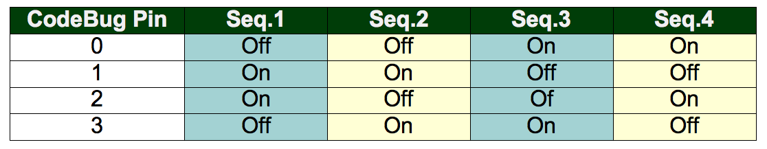

Depending on the order and logic levels when the stepper motor receives the four pulses to the coils it moves, one step every series of pulses. The rotation speed is determined by the frequency of the pulses. With the four PINs there are 4 logic configurations that should be sent in order to move the motor by steps:
When all the four pulses are sent to Off the motor does not moves. The four sequence values in the order 1-2-3-4 moves the motor clockwise while the sequence in the opposite order 4-3-2-1 moves the motor counterclockwise.

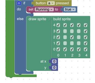

The CodeBug graphic program

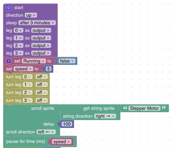

1. Initialisation
The first part set the four PINs of the CodeBug as output. The variable Speed is set to the default value: this is the number of ms that the program wait after every sequence. As high is the speed value as low is the motor speed and vice-versa.
First of all all the four PIN (legs) of the CodeBug are turned Off so the motor is initially stopped. The other task of the initialisation part is writing the scrolling text. All this part runs once when the program start.

The program should run continuously enabling the user to run or stop the motor. A similar procedure we are used to see in the Arduino and other microcontroller boards is reached by an infinite loop.
The On/Off motor state instead is controlled by the boolean variable Running initially set to false (the motor is stopped).

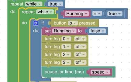

3. Motor control
The control of the motor is managed by the two tactile push buttons A and B of the CodeBug: the first starts the motor, the second stop it. The two images below shows the two cases. Note that when the button B is pressed, together with changing the state of the Running flag the motors is stopped.

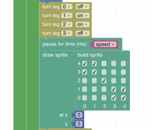

4. Executing a step
The following image shows the code relative to the execution of a single step.
The four PINs (legs) of the CodeBug are set to the desired pattern (see the table above) then the program pauses for the speed number of milliseconds. Last action is drawing the sprite corresponding to one of the four positions to animate the display.

To see the simple motor stepper controller at work take a look to the following video.
